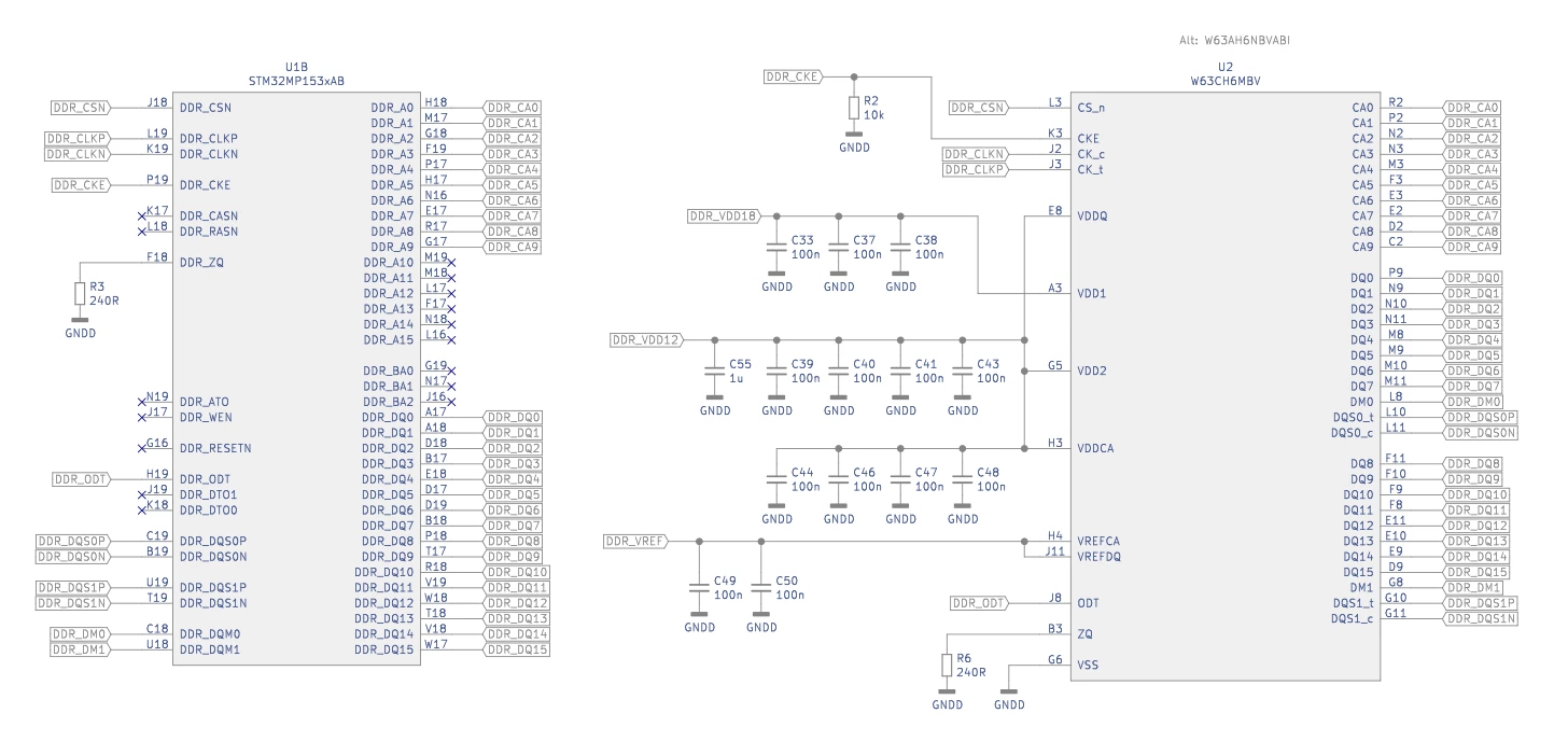

I have read the mentioned app notes, the only thing I overlooked is the 100R termination resistor on CLKN/CLKP. I added it directly on vias under the LPDDR3 chip now but still no luck.
Regarding the software, u-boot in the v3.1 ecosystem is very old. I was using the upstreamed support in the v2022.04-rc4. I will compare the changes to v3.1 ST's u-boot.

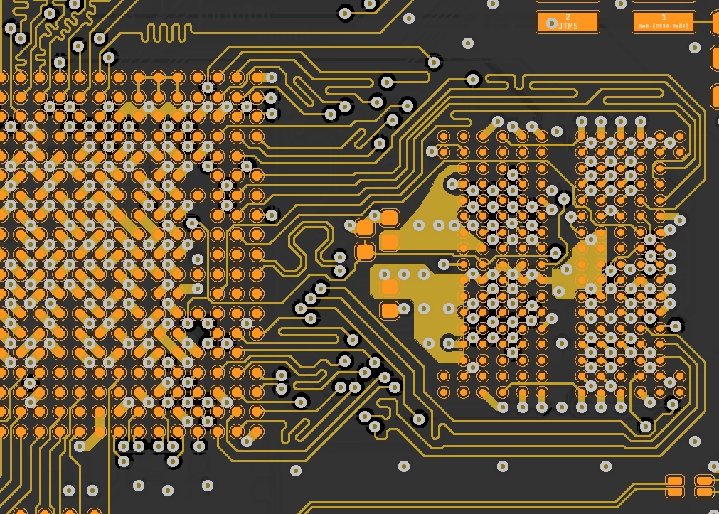

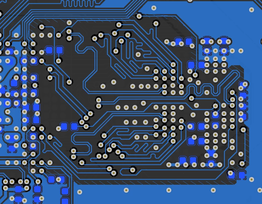

I am attaching the schematic cutout and routing. Individual tracks within byte lanes are matched to 0.1 mm, DQ0-7 is 18 mm, DQ8-15 is 16 mm, CA is 30 mm (the difference of 14 mm is a bit marginal).
0693W00000LvwpeQAB.pngTop layer:0693W00000LvwqhQAB.pngBottom layer:

Hi, you schematic sound ok. I assume the DDR_VREF is also connected to STM32MP15x.
I confirm the 100ohms on DDR clock was missing in AN5031 (but listed in AN5122 and in our schematics PCB examples).
Otherwise, I cannot comment more on SW version aspects as I have an HW focus.

Thanks for confirming the schematic is correct. Yes, DDR_VREF is connected to STM32MP15x too.

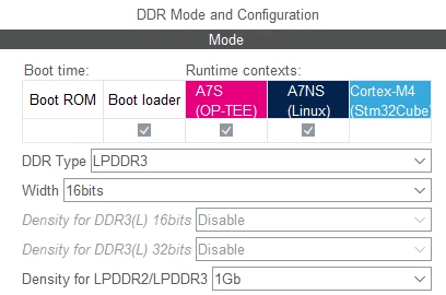

I tried regenerating the DTS again, this is the output of CubeMX:
 * Copyright (C) 2015-2018, STMicroelectronics - All Rights Reserved
 * SPDX-License-Identifier:	GPL-2.0+	BSD-3-Clause
 * File generated by STMicroelectronics STM32CubeMX DDR Tool for MPUs
 * DDR type: LPDDR3
 * DDR width: 16bits
 * DDR density: 1Gb
 * System frequency: 533000kHz
 * Relaxed Timing Mode: true
 * Address mapping type: RBC
 * Save Date: 2022.03.28, save Time: 12:34:50
#define DDR_MEM_NAME	"LPDDR3 16bits 533000kHz"
#define DDR_MEM_SPEED	533000
#define DDR_MEM_SIZE	0x8000000
#define DDR_MSTR 0x00040008
#define DDR_MRCTRL0 0x00000010
#define DDR_MRCTRL1 0x00000000
It can be seen that the width is correctly set to 16 bit, despite that CubeMX generated MSTR register value 0x00040008 corresponding to a 32 bit wide DDR. The correct value should be 0x00041008 (half DQ bus width) according to the datasheet.

which version of CubeMX are you using ?
Tested on v6.4 (the one which must be used with Ecosystem v3.1) and give me MSTR value of 0x00041008 .
See attached file for
Regards.
In order to give better visibility on the answered topics, please click on 'Best Answer' on the reply which solved your issue or answered your question.Tip of the day: Try Sidekick STM32 AI agent
PatrickF
Mar 28, 2022 11:56 UTC
previous file was for 400MHz. Find attached file generated for 533MHz
qyx
qyxAuthor
Mar 28, 2022 18:24 UTC
I am using CubeMX 6.5, downloaded a fresh one. I tried both your DTS files with similar results. So I changed the DDR clock to 200 MHz, somehow managed to generate the correct DTS and modified DDR test 3 to get some insight to what can be read from the memory.
