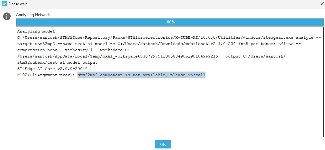

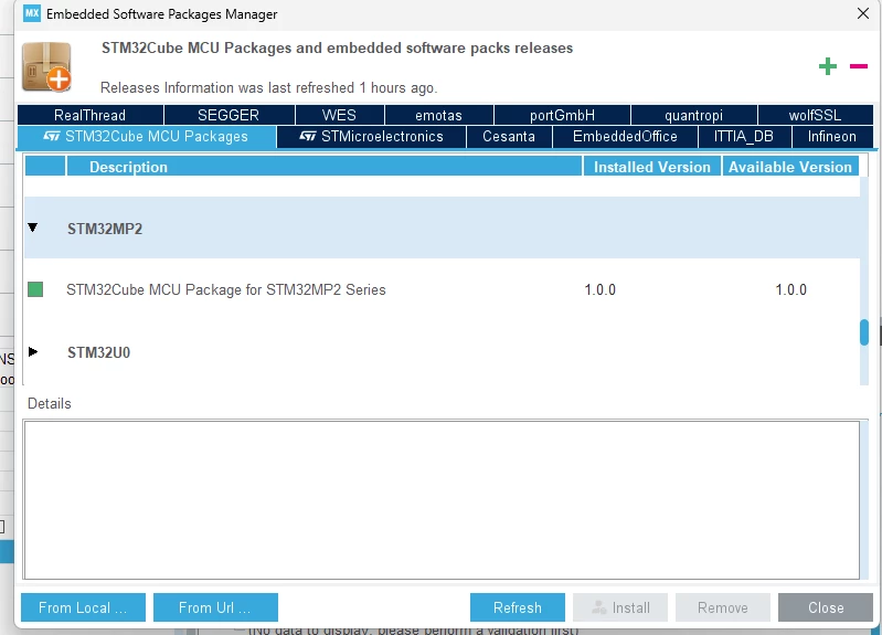

I am trying to create a project from STMcubeIDE (v1.16.1) for STM32MP257-DK and would like to load a .tflite model on Cortex M33 and run inference to the model. However, when I was creating the project, I brows to my test model from the .ioc file and when I tried to Analyze, It throws the "stm32mp2 component is not available, please install" error. I double checked that the stm32mp2 is already installed. Can anyone please let me know if I am missing anything here. Below are the images for error logs and stm32mp2 installed image.
Error image:

stm32mp2 installed image:

It's seems you are using ST Edge AI Core analyze command here.
As is it state in this wiki page :
"The analyze commands in ST Edge AI for STM32MPUs are currently under development and will be available in a future release."
I recommend you to use generate command to convert your TFlite model to a network binary graph (NBG) and use the validate command to run an inference on your board to obtain different metrics.

Dear @Santosh-Italiya ,
The STedgeAI stm32mp2 target is referering to the cortexA with Linux ecosystem. The analyse is not yet supported for this stm32mp2 (Linux cortexA) target.
To generate a code for cortexM33 of the STM32MP2 the trick consists in creating a code for a STM32 cortexM33 target and to port the resulting AI code into a STM32MP2 cortexM33 project.
The native support of the CortexM33 is not yet available.
