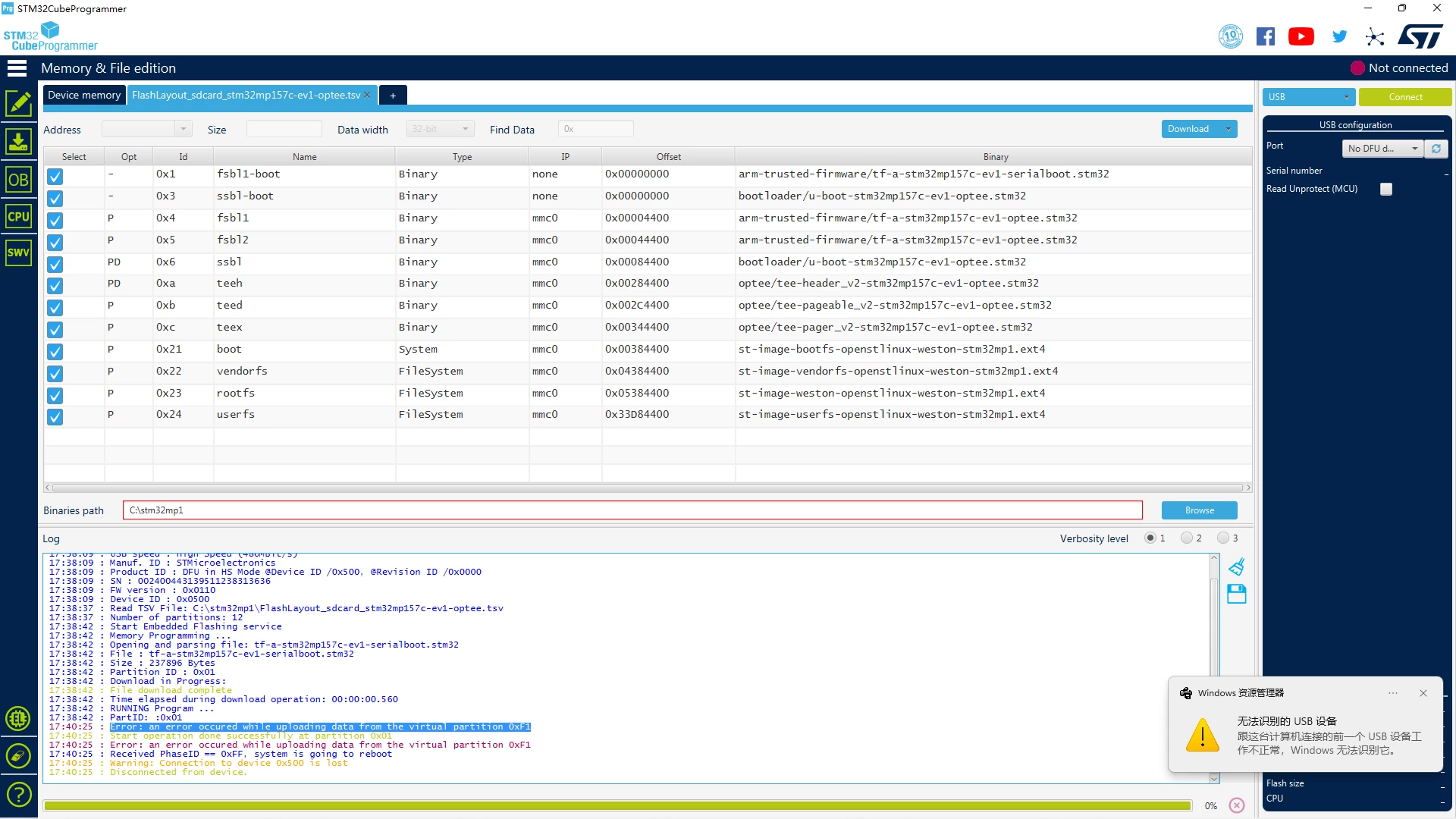

Can't write the Stm32mp1 boot device by STM32CubeProgrammer
  • July 29, 2022
  • 1 reply
  • 1317 views
Hello, I use the STM32CubeProgrammer to write Stm32mp157c board boot TF card. But it fail. How can I fix this problem?

Hi @WHe.1​
looking at your TSV, you are using an old ecosystem (v2.1 likely) with an STM32MP157C-EV1 board.
Which version of STMCubeProg are you using ?
I tested to load en EV1 board with CubeProg v2.11 on W10 without issue.
Maybe worth to get console log output (available on STLINK VCP comm port).
Anyway, I recommend you to switch to latest ecosystem (V4.0) together with latest STM32CubeProg (v2.11)
some guidelines could be found on wiki
https://wiki.st.com/stm32mpu/wiki/Getting_started/STM32MP1_boards/STM32MP157x-EV1/Let%27s_start/Populate_the_target_and_boot_the_image
Regards.
