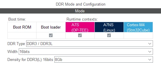

Can STM32MP157C support 1Gbytes DDR3L RAM in 512Mx16 Configuration? For example Micron Part MT41K512M16VRP-107 IT?

Oct 20, 2021 09:04 UTC
yes, a single 8Gbit 16-bits DDR3L is supported.
0693W00000FD7QgQAL.pngRegards,

Thanks for the reply.
I do notice this and note that it support but has anyone successfully implemented it? So far, I haven't come across a board that uses implementation of Single chip 512Mx16 to get 1Gbytes Ram but mostly implementing 2x 256Mx16 configuration (32 bits bus width) to get 1Gbytes RAM. I'm a little concern on the DDR tuning when implementing 1x 512Mx16 DDR3L RAM as I haven't come across any device tree that implemented 512Mx16 configuration.
