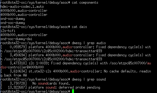

Can STM32MP151 transfer sound via HDMI connector?
I'm buildning my own computer by using STM32MP151AAC3.
I'm going to draw lines for the HDMI connector. I have one question: Can I transfer sound via the HDMI cable? For example if I run OpenSTLinux onto the STM32MP151AAC3 processor, and then I connect the HDMI cable and I can see the screen. Will I be able to hear sound too if I surf into Youtube?
DMårtBest answer
Lead
Oct 29, 2024 8:41 PM UTC
@PatrickF
Hi!
I solved the problem. Now I can hear sound from my SII9022A PHY.
I did not use ASoC Graph Card, instead I used Simple Card inside Linux kernel.
I post the Linux Device Tree in case if some one in the future want to play some music through the SII9022A.

Oct 26, 2024 6:23 PM UTC
Hi @PatrickF
Note! What you are refering to is not the HDMI PHY.
You refering to another IC chip.
The linux kernel does not support sii9022A without MCLK.
I get these debug messages from sii902x.c https://github.com/torvalds/linux/blob/master/drivers/gpu/drm/bridge/sii902x.c because my device requries MCLK. I have not routed that track from my MCU to the PHY. So sound won't work for the moment until sii902x.c supports PLL as a clock instead of only MCLK.
 if (daifmt->bit_clk_provider || daifmt->frame_clk_provider) {
 dev_dbg(dev, "%s: I2S clock provider mode not supported\n", __func__); <--------------------------
 return -EINVAL;
 switch (daifmt->fmt) {
 case HDMI_I2S:
 i2s_config_reg |= SII902X_TPI_I2S_FIRST_BIT_SHIFT_YES |
 SII902X_TPI_I2S_SD_JUSTIFY_LEFT;
 break;
 case HDMI_RIGHT_J:
 i2s_config_reg |= SII902X_TPI_I2S_SD_JUSTIFY_RIGHT;
 break;
 case HDMI_LEFT_J:
 i2s_config_reg |= SII902X_TPI_I2S_SD_JUSTIFY_LEFT;
 break;
 default:
 dev_dbg(dev, "%s: Unsupported i2s format %u\n", __func__, daifmt->fmt); <--------------------------------
 return -EINVAL;
The device tree requries the mclk.
https://www.kernel.org/doc/Documentation/devicetree/bindings/display/bridge/sil%2Csii9022.yaml

DMårtAuthor
Lead
Oct 27, 2024 10:39 PM UTC
Hi @PatrickF
I have updated my DT.
Instead of ASoC Audio Graph Card, I'm using Simple Sound Card instead. It seems like I can get a hdmi-audio-codec and ha i2s-hifi...I don't know what they are doing.

DMårtAuthorBest answer
Lead
@PatrickF
Hi!
