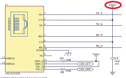

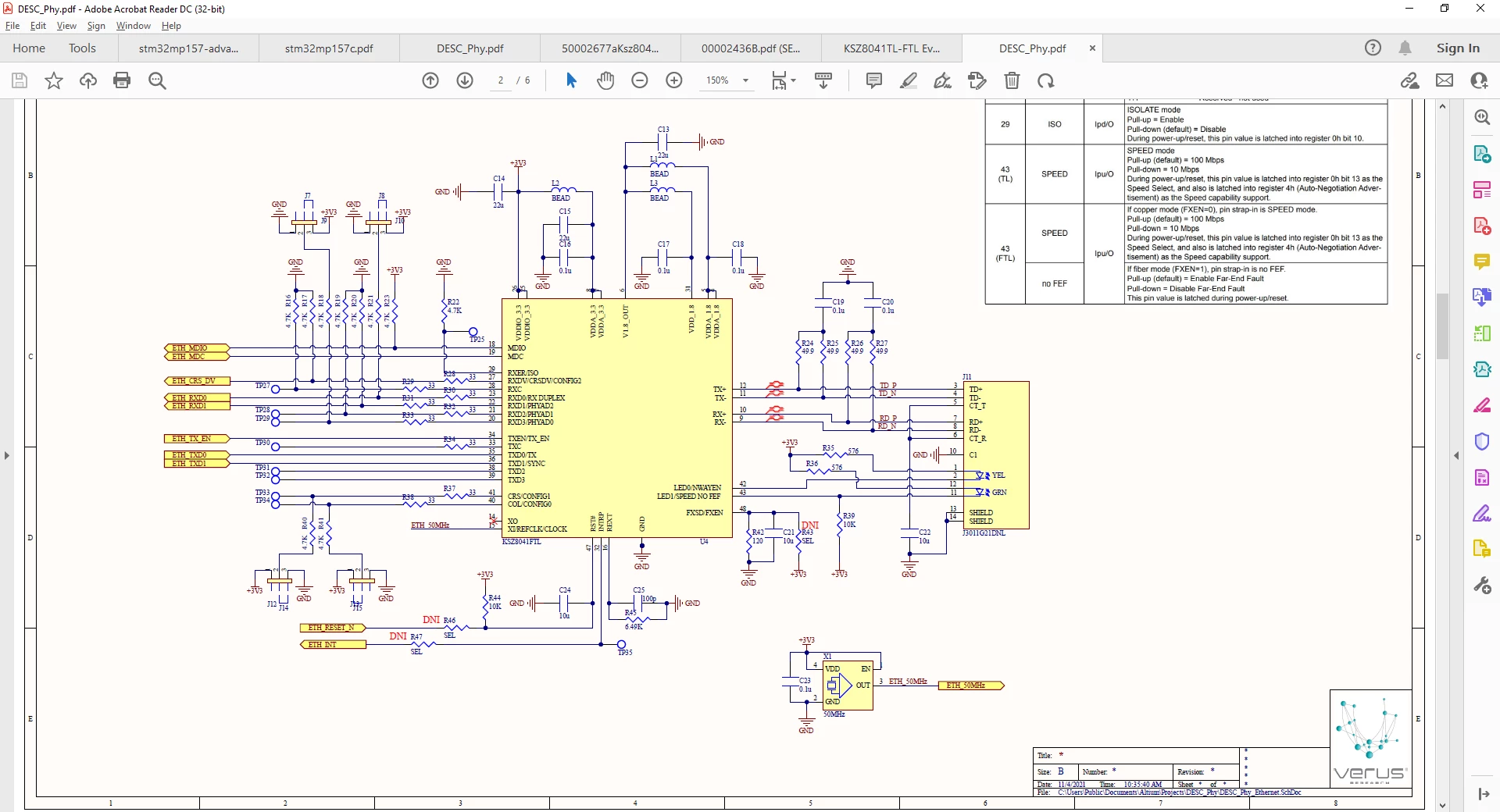

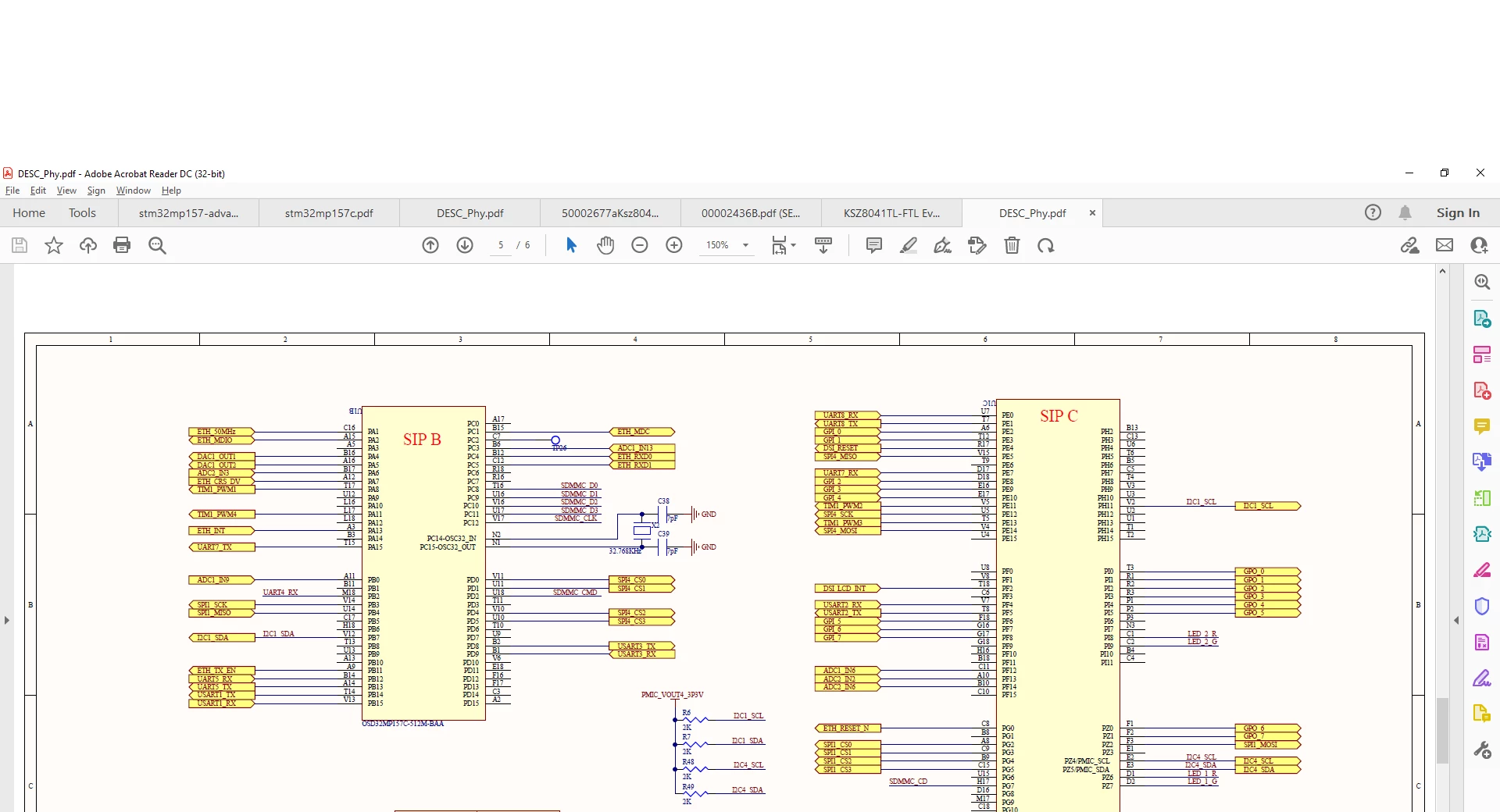

Can someone please help. We are trying to implement a KSZ8041FTL Ethernet PHY using an STM32MP157C. We are not able to connect to the device via MDIO. The device does not respond.
We are trying to implement a KSZ8041FTL in an embedded design. We are using an STM32MP157 device in a SOC provided by Octavo systems (OSD32MP157C-512M-BAA). We have used design resources provided by Microchip and followed examples provided. We have followed resources provided by STMicro to configure the pin connections and device tree for the PHY. We are not able to connect to the device via MDIO. The device does not respond. The resulting output on the Linux kernel log indicates that MDIO device at address 3 is missing. We have the device strapped to address 1. We see MDC and MDIO activity when the device is being probed but it always reports device missing at address 3. There is no response from the PHY. We have verified the presence of the 50Mhz ref to the PHY and monitored the reset line, configuration pins, and address pins. Nothing appears wrong. What are we missing?

Hello Olivier,
Yes, the root cause of the connectivity issue was the missing power connection to the RJ45 magnetics transformer. We have tested and confirmed the PHY is fully functional.

OlivierK
Nov 5, 2021 10:30 UTC
Hello PZak.1 (Community Member),
You seem to have an issue in your DT while declaring the phy subnode, can you share it please? along with your DT pinmuxing .
I guess you've already checked this article? https://wiki.st.com/stm32mpu/wiki/Ethernet_device_tree_configuration.
Check also that you are currently working with the latest rev of the KSZ8041 driver.

I will include these entries back into the device tree. We just found a hardware wiring problem where we neglected to tie the RJ45 magnetics transformer center taps to VDDA. I have a board being reworked right now and will let you know if this solves our connection problem.
Best regards and thank you for continuing to support us,
Paul

PZak.1
PZak.1AuthorBest answer
Nov 16, 2021 14:36 UTC
Hello Olivier,
Best regards,
Paul
