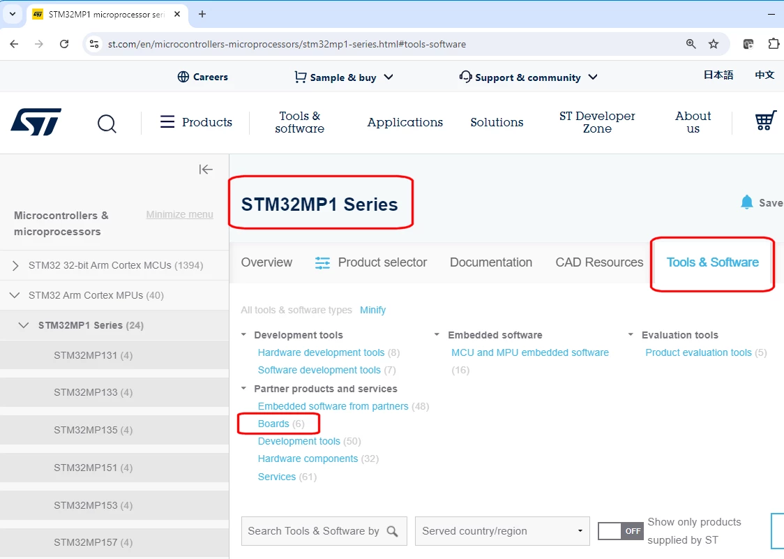

Andrew Neil
Aug 26, 2024 11:37 UTC
"Best" is meaningless unless you give some criteria by which to judge it.
On ST's pages for each of the STM32MPxx Lines you've tagged, go to the 'Tools & Software' tab - there's a link there for available boards:
See which of those meet your requirements ...
Why do you think you "need" an MPU (rather than an MCU)?
What level of performance do you need?
Memory? Storage?
The board neither knows nor cares what IDE you use.
