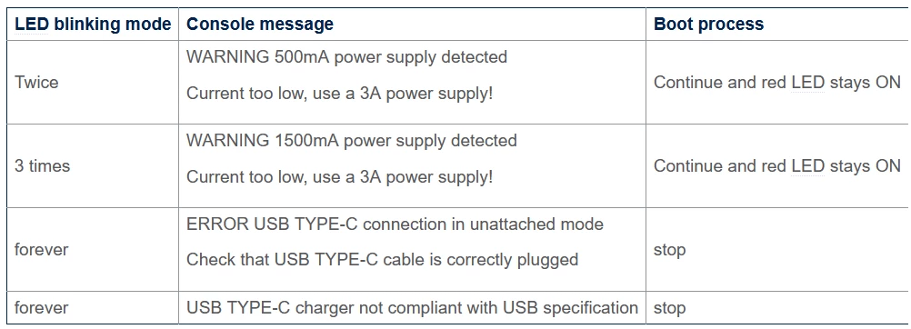

according to your uBoot log, your 5V power supply is not compliant to USB Type-C standard (usually CC lines not or badly connected).
This will stop the Starter Package uBoot with red led blinking.
See https://wiki.st.com/stm32mpu/wiki/Getting_started/STM32MP1_boards/STM32MP157x-DK2/Let%27s_start/Populate_the_target_and_boot_the_image

Solution could be either :
or
First option is straightforward.
Regards.

I switch power supplies and now I am able to Flash the SD Card.
Good = Ultranet CX65UC002 Ultron GaN 65W Type-C PD Charger
Bad = CUI Inc. SWC15-S5-NB Wall Mount AC Adapter 15W 5V 3A
