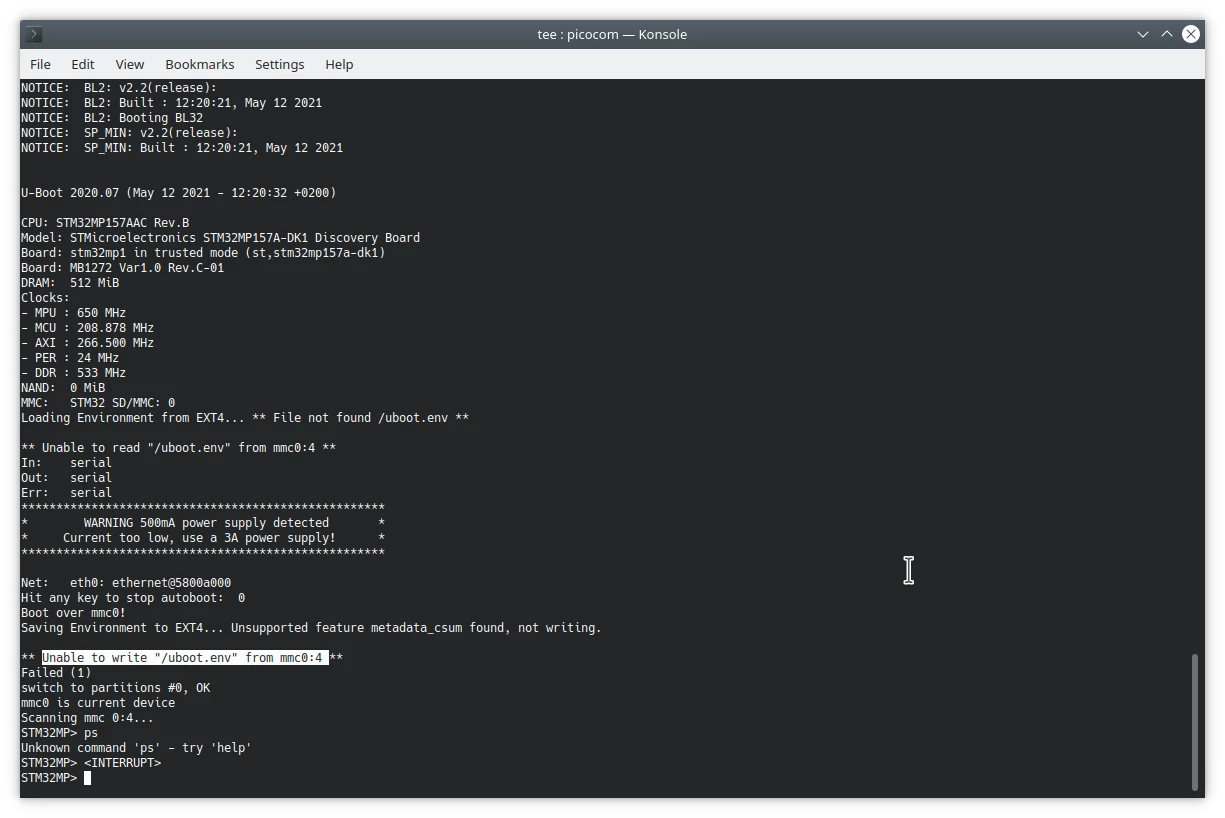

Hello !
I'm trying to boot an STM32MP157a-dk1 using an image that i made with build-root but when i boot i got this message :
Unable to write "/uboot.env" from mmc0:4 0693W00000AP51iQAD.png
刘振国.1
Visitor II
Oct 20, 2021 14:52 UTC
Hello!
change buildroot/configs/stm32mp157a_dk1_defconfig file
BR2_TARGET_ROOTFS_EXT2_MKFS_OPTIONS="-O ^metadata_csum"
