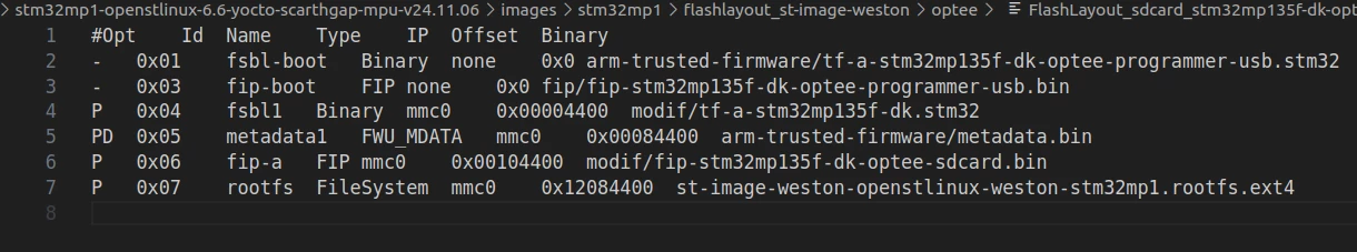

1. Procedure followed
  • Built a new FIP binary and tf-a with the recommended changes and flags:
    -> fiptool update --fw-config stm32mp135f-dk-fw-config.dtb --hw-config stm32mp135f-dk.dtb --nt-fw Image fip-stm32mp135f-dk-optee-sdcard.bin
  • Modified the TSV  in the starter package to replace u-boot.bin with my Linux image and updated the FIP entries as follows:
    2. Observed output:

I think the TF-A BL2 config is not correctly updated
https://wiki.st.com/stm32mpu/index.php?title=How_to_optimize_the_boot_time#STM32MP1_series
We will so adapt our plat/st/stm32mp1/stm32mp1_def.h with following declarations :
#define STM32MP_BL33_BASE (STM32MP_DDR_BASE + U(0x2008000))
#define STM32MP_BL33_MAX_SIZE U(0x3FF8000)
instead of
#define STM32MP_BL33_BASE (STM32MP_DDR_BASE + U(0x100000))
#define STM32MP_BL33_MAX_SIZE U(0x400000)
But in trace, the BL33 image 5 is loaded at the U-Boot location (start of DDR) and not at the updated address  = 0xC2008000 for Linxu start adress
> INFO: Loading image id=5 at address 0xc0000000
> INFO: Image id=5 loaded: 0xc0000000 - 0xc15555cc
normally the information is in the fw-config file "stm32mp135f-dk-fw-config.dtb"
added in FIP when you execute the command
$> fiptool update --fw-config stm32mp135f-dk-fw-config.dtb --hw-config stm32mp135f-dk.dtb --nt-fw Image fip-stm32mp135f-dk-optee-sdcard.bin
You can check content of FIP  and of device tree with
$> fiptool unpack fip-stm32mp135f-dk-optee-sdcard.bin
$> fdtdump fw-config.bin

So it seens the fw config in the FIP is updated on nt_fw (id = 5) only for max-size and not for address  !?
nt_fw {
load-address = <0x00000000 0xc0000000>;    <=>  STM32MP_DDR_BASE + U(0x2008000)
max-size = <0x03ff8000>;                                 <=>  U(0x3FF8000)
id = <0x00000005>;
Please clear the TF-A generated files after modification to be sure fw config is fully generated
and  try again to generate the FIP
And check the content of generated file stm32mp135f-dk-fw-config.dtb....
