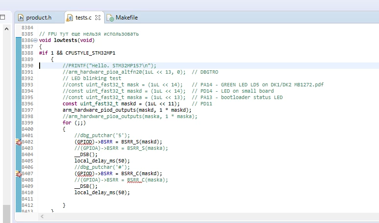

I was hoping to find any examples/pre-built applications which can be run off the SD card to simply turn on an LED or so, for the STM32MP157A dev kit. Can anyone point me to any resources like this?

Hi @Community member​. Thanks for the feedback. I'm aware what the kit comes with by default, but what I'm looking to do is a hardware proof of concept. Effectivly we're creating a new board, with a STM32MP151 as the main processor. In order to help validate the hardware is working, I'd like to have a completely minimal subset of instructions to simply, say, illuminate a LED.
Before I go working with my own hardware on the 151, I thought this should be a pretty quick thing to try out on the devkit with the 157. Looked like if I wrote code to simply enable LEDs LED_Y (PH7/W4) or LED_B (PD11/AC10) it would be a great quick test of hardware.
You mentioned that there is no solution for the A7 side which is supported. What about the M4? Do both cores have access to the same set of pins?

Look my project here (branch develop):
https://github.com/ua1arn/hftrx
Bare metal Cortex-A7 image following.

useful files and your test (fsbl.stm32)
ps: sorry. only one attachment per message allowed.
