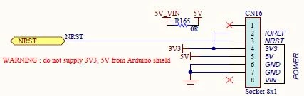

I am working with stm32mp157-dk2.
Arduino connector CN16-pin5 is giving 5v.
How can I switch on/off this pin in my M4 program ?

This pin is tied to 5V_VIN (VBUS supply from USB Type-C connector CN6) thru a 0ohm resistor. No way to switch off by SW.
This 5V is present on all Arduino.
On STM32MP157-DK2, in case of conflict with your Arduino shield, you could disconnect it permanently by removing R165 (visible on PCB close the the 5V CN16 pin).

thank you. I dont use Arduino shield. I just want to control a 5v ventilator with m4 program on dk2 board. (just switching on / off)
I think I should use gpio connectors. There are two gpio pins that give 5v supply.

Altough GPIOs could sustain 5V, they are limited in power to about 20mA (with 1.3V output, which mean only 3.7V remain on the load), so you probably can't control a fan power in that way. You must add a transistor or similar power control.
To control FAN, you could better make use of a PWM fan (e.g. most fan used in computers) which could be supplied from 5V or 12V directly whereas the PWM pin could be handled directly by a timer output in 3.3V from STM32MP1 to control fan speed from 0 to 100%.
Alternatively, if intermediate speeds are not required, a simple GPIO on the fan PWM pin could control from 0 or 100% (i.e. OFF/ON).
