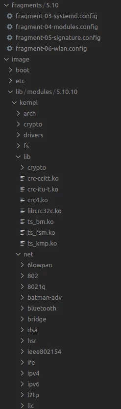

Adding WLAN to STM32MP157-DK2 does not copy modules. What is wrong?
Hi everyone
I am trying to modify the Kernel during the Distribution Package method (compiled from Yocto directly to the image)
I have followed the information in the following pages:
https://wiki.st.com/stm32mpu/wiki/WLAN_overview
https://wiki.st.com/stm32mpu/wiki/How_to_customize_the_Linux_kernel
https://wiki.st.com/stm32mpu/wiki/Menuconfig_or_how_to_configure_kernel
My setup is importing the meta-st-stm32mp, adding my own layers and building an image from core-image (no OpenSTLinux in this case)
MACHINE = "stm32mp1-disco"
I have created a .bbappend recipe as follows:
FILESEXTRAPATHS:prepend := "${THISDIR}:${THISDIR}/linux-stm32mp:"
KERNEL_CONFIG_FRAGMENTS:append = "${WORKDIR}/fragments/5.10/fragment-06-wlan.config"
SRC_URI:append = " file://5.10/fragment-06-wlan.config;subdir=fragments "
SRC_URI:class-devupstream += "file://5.10/fragment-06-wlan.config;subdir=fragments"
# Autoload WiFi driver on boot
KERNEL_MODULE_AUTOLOAD:append = "brcmfmac"
IMAGE_INSTALL:append = " kernel-module-brcmfmac linux-firmware-brcmfmac "
File fragment-06-wlan.config looks as follows:
CONFIG_BRCMFMAC=m
CONFIG_BRCMUTIL=m
CONFIG_WLAN_VENDOR_BROADCOM=y
CONFIG_WLAN=y
CONFIG_NETDEVICES=y
CONFIG_CFG80211=m
Inspecting .config in work/stm32mp1_disco-poky-linux-gnueabi/linux-stm32mp/5.10.10-r0/build shows that these changes were included.
Looking at the build folder for linux-stm32mp looks like this:
0693W00000Lya5fQAB.pngI can find all the modules and drivers that I wish to load.

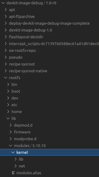

If I inspect the build folder for my output rootfs, I get this:
0693W00000Lya6dQAB.pngClearly the end result does not includes the modules and drivers I was hoping to see there. Of course flashing the image leads to the same result, thus modules cannot be loaded.
Could someone advise what am I missing?
bodashmas
bodashmasBest answer
Apr 23, 2022 12:45 UTC
Solved.
My image was ovewritting IMAGE_INSTALL and leaving out packagegroup-base-extended \
