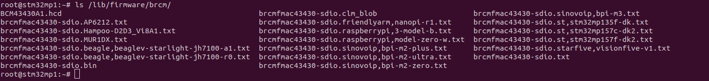

I have also noticed the following errors appearing in the boot log
[   3.693682] brcmfmac: brcmf_fw_alloc_request: using brcm/brcmfmac43430-sdio for chip BCM43430/1
[   3.701290] brcmfmac mmc1:0001:1: Direct firmware load for brcm/brcmfmac43430-sdio.st,stm32mp157f-dk2.bin failed with error -2
[   3.706342] ehci-platform 5800d000.usb: USB 2.0 started, EHCI 1.00
[   3.712590] brcmfmac mmc1:0001:1: Direct firmware load for brcm/brcmfmac43430-sdio.bin failed with error -2
[   3.719889] hub 1-0:1.0: USB hub found
[   3.732237] hub 1-0:1.0: 2 ports detected
[   3.739743] cfg80211: Loading compiled-in X.509 certificates for regulatory database
[   3.764460] cfg80211: Loaded X.509 cert 'sforshee: 00b28ddf47aef9cea7'
[   3.770013] platform regulatory.0: Direct firmware load for regulatory.db failed with error -2
[   3.778297] cfg80211: failed to load regulatory.db
Maybe it's related to this issue? Any hint about it?

can you verify that the firmware is actually deployed? It should be in /lib/firmware/brcm/
FBofi.1
FBofi.1Author
Oct 25, 2022 15:46 UTC
Hello @Tom�? Ju?ena​ , @Kevin HUBER​
I checked the files in "/lib/firmware/brcm/" directory and I found "brcmfmac43430-sdio.bin" but not "brcmfmac43430-sdio.st,stm32mp157f-dk2.bin" file. Attached an image that shows the files contained in this directory
