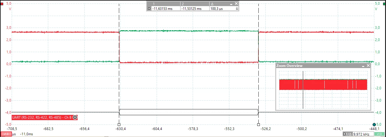

Actual UART Baudrate is off from what is specified
I am using UART over RS-485 on an STM32MP153AAB3.
The communication fails because the actual baudrate is off from the specified baudrate. With a specified baudrate of 9600 Bits/s, I am getting an actual baudrate of 9970 Bits/s, as you can see here (time per Bit is 100.3µs instead of 104µs):

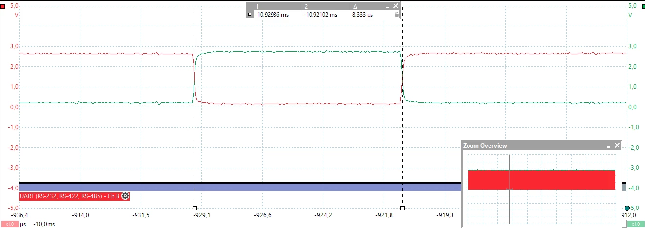

Changing the baudrate to 115200 Bits/s results in a time per Bit of 8.33µs, i. e. 120000 Bits/s:
 0693W00000aPNieQAG.pngI set the USART2,4 Clock in the .ioc file to 64 MHz and chose PCLK1 as the source.
The value in the BRR register is 0x1A0B which, if I understand it correctly, should correspond to a value for USARTDIV of 416, giving a baudrate of 9615 Bits/s (64,000,000/(16*416) = 9615).

Peter BENSCH
Mar 29, 2023 10:01 UTC
The 3...4% deviation sounds like the use of HSI or CSI, both untrimmed.
Where does the 64MHz come from that you are using? PCLK1 is derived from APB1, which in turn comes from MCUSS_CK, which gets its clock from HSI, CSI, HSE or PLL3P.
Regards
/Peter
RPape.1
RPape.1Author
Mar 29, 2023 10:27 UTC
Yes, you're right, I am using HSI.
How do I find out whether the HSI is trimmed or not?
I checked the RCC_HSICFGR register and there are some bits set in HSITRIM and HSICAL (HSICFGR is 0x34A1700), but does that mean these are correct calibration values?
Edit:
I now tried a whole new board, but the behavior is still exactly the same - the measured baud rate is still 9970 Bits/s for a specified baud rate of 9600 Bits/s.
Edit2:
I tried specifying our 25 MHz HSE as the clock source, but it also does not make a difference. I suspect it is because I am booting in production mode, so I will have to change this on the Linux side, which is what I'll try next.
Edit3:
Okay, we changed the clock source to HSE on the Linux side and now it works like a charm. Thanks for the help, Peter!
I would still be interested if anyone knew how to trim the HSI so that it works, though :)
