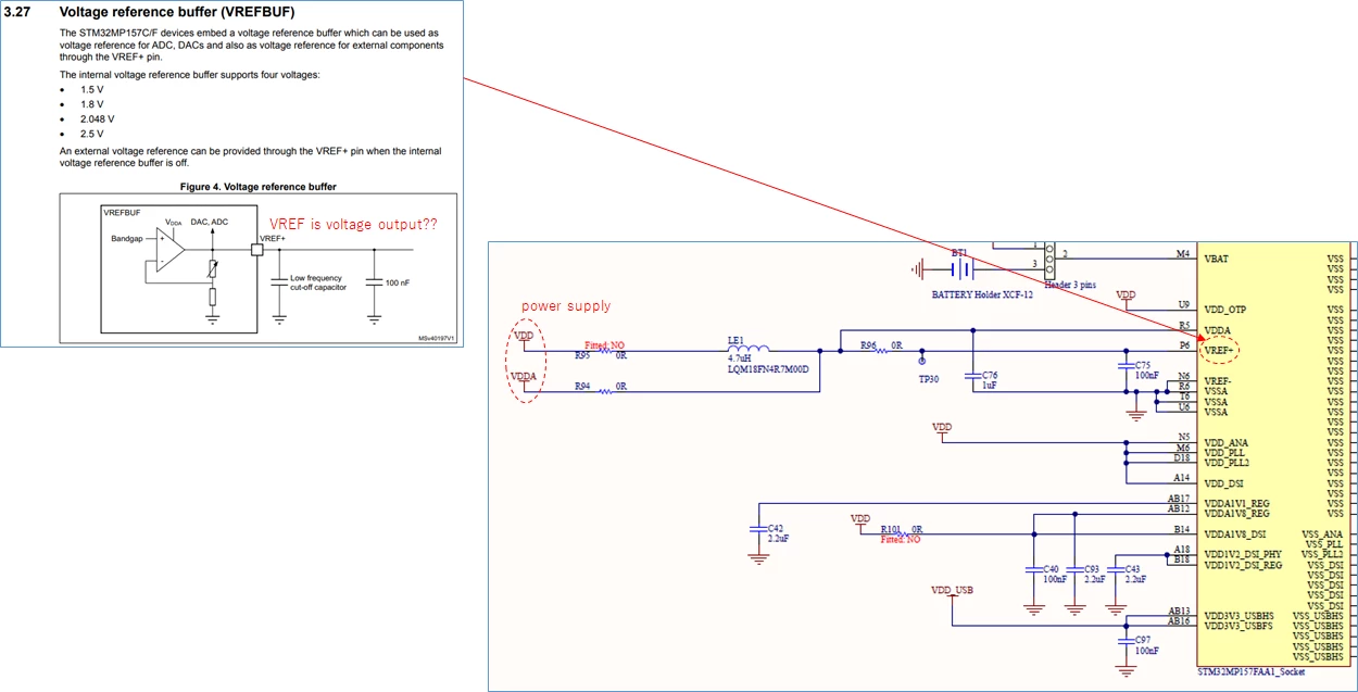

in datasheet, it's mentioned that "An external voltage reference can be provided through the VREF+ pin when the internal voltage reference buffer is off". so external Vref+ mode is used on the board.

Maybe read the text in the image you posted?

Don't forget to add a 1uF capacitor for decoupling when used as output.
