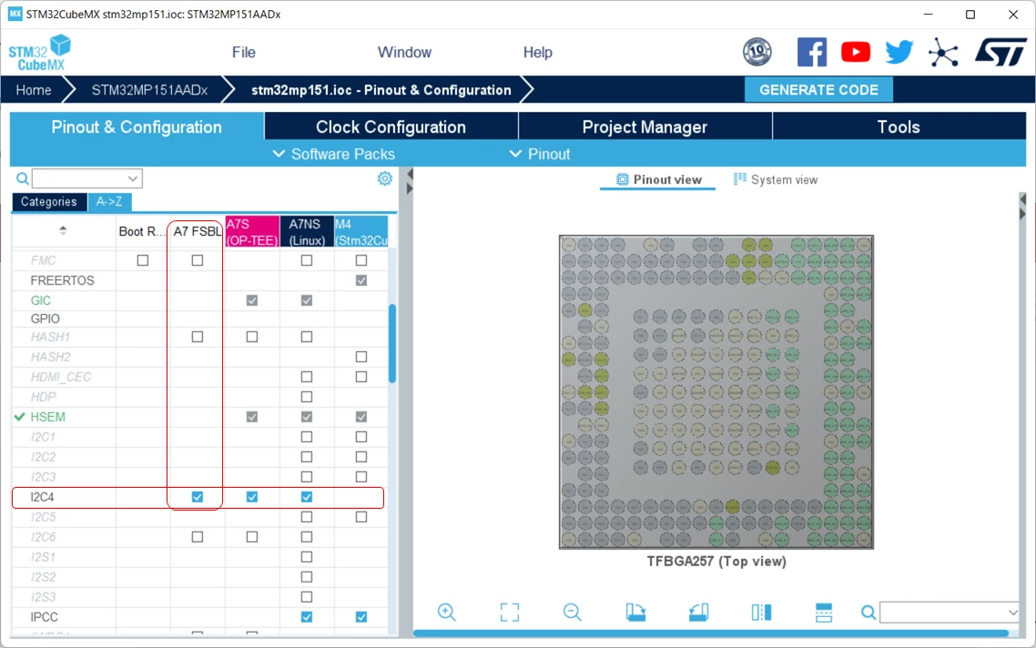

tatsuya
tatsuyaAuthor
Nov 15, 2022 06:56 UTC
Hi Olivier-san,
Thank you for your reply.
Would it be okay if the I2C4 setting could be set up in STM32CubeMX like an attachment?
Best regards,
