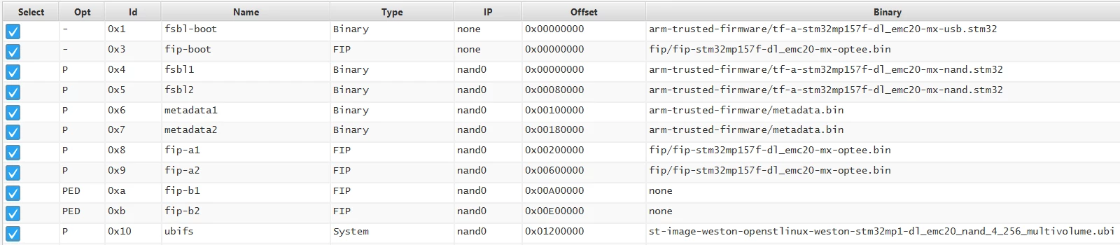

NAND is used, there is no difference compared to the EV board TSV.

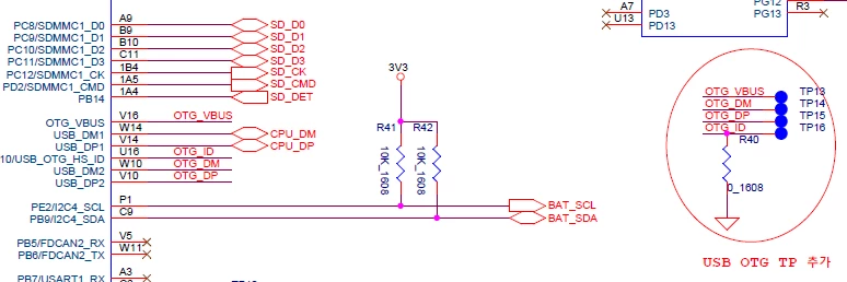

And the USB port was used as a test point without using a connector.
