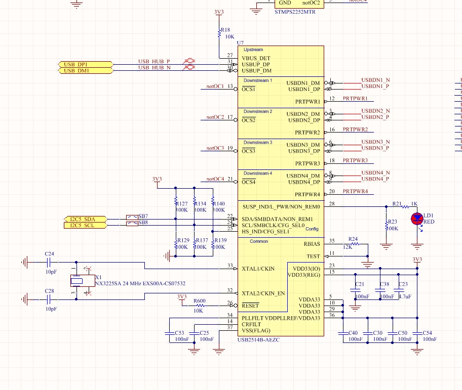

Hi!
After starting custom board there are a lot of similar messages in dmesg (10 per second):
[ 200.480616] dwc2 49000000.usb-otg: Overcurrent change detected
[ 203.598775] dwc2 49000000.usb-otg: Overcurrent change detected
USB is not working. LED on USB2514B-AEZC hub blinking several times per sec.
What is the reason for this message and how to debug this?
USB_OTG circuit have no visible hardware problems.
Thank you in advance
Looking forward for your reply
Best answer by ASkri.1
There was no hardware issues. But there was a mix of two kind of problems - first wrong DT for USB. Second here:
https://community.st.com/s/question/0D53W000016lFbVSAU/usb2514-usb-hub-cant-connect-highspeed-devices
Wrong value for USB bias resistor.
Thank you for your support :)

strange behavior as USB2514 is an USB hub (so, connected to USBH) and the log message is for OTG. Maybe some mixed-up in the DT.
could you share your HW schematics around :
  • USBH (USB_DP1/DM1 pins) + USB hub (USB2514B-AEZC)
  • OTG (I assume USB_DP2/DM2, VBUS, ID)
  • VBUS generation for OTG (when in host mode)
  • STPMIC1 (if any)
could you share also your uBoot device tree.

Thank you very much for quick reply. There are nothing special in the schematic - mostly copy-pasted from ST's reference boards:
USB_HUB connected to USB_DM1 (USB1_N pin of MCU) and USB_DP1 (USB1_P pin of MCU) pins:
0693W00000F9xROQAZ.pngOTG connector connected just to USB2_P and USB2_N connector. And currently disconnected.
OTG_VBUS (OSBO_VBUS pin of MCU) currently not connected
VBUS pin of OTG connector connected directly to 5V system power input and used to power target board.
I also suspect problems with DT because I definitely remember, that there was no problems with USB recently
with less customized images on the same board.
Please find attached DT files for my project.
