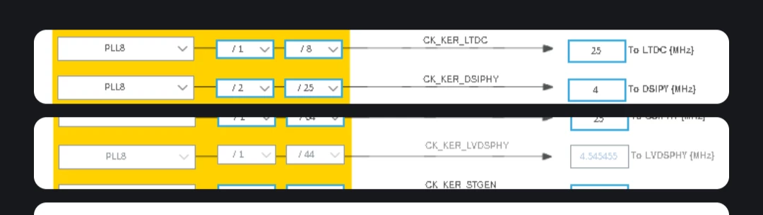

Hi!
I think there is some display issues with STM32CubeMX with the cr_ker_ltdc
If I look in the clock summary, I csn see that the ck_ker_ltdc is set to 100 MHz.
ck_flexgen_27 0 0 0 100000000 0 0 0 Y deviceless no_connection_id
    ck_ker_ltdc 0 0 0 100000000 0 0 50000 N 48010000.display-controller lcd
                                                                                                              48000000.dsi px_clk
       clk_pix_ltdc 0 0 0 100000000 0 0 50000 Y 48010000.display-controller ref

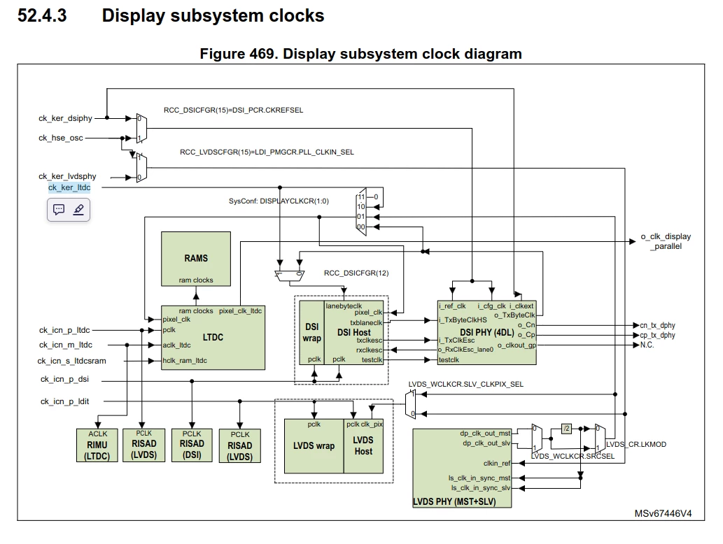

In this case, I need to increase the cr_pix_ltdc to above 148.5 MHz to achieve full HD at the HDMI output.
But in the CubeMX, I see that the cr_ker_ltdc is set to 25 MHz.
And changing the cr_ker_ltdc will affect the cr_pix_ltdc  according to the reference manual.
So is this an issue or not?

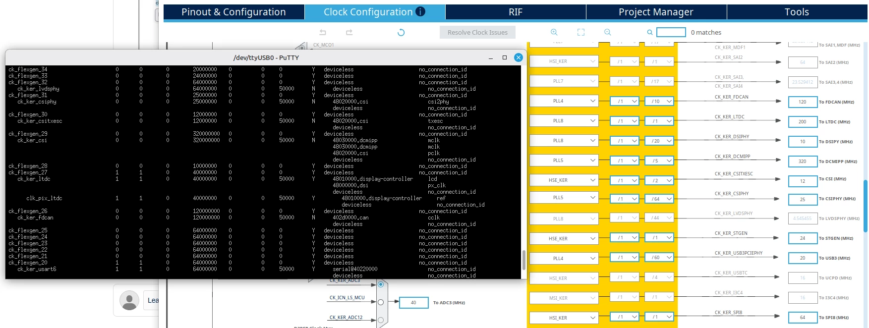

Here is another proof.
As you can see, ck_flexgen_28 is set to 10 MHz. That’s correct according to CubeMX.
But ck_ker_ltdc is 200 MHz in CubeMX, but in clk_summary, it’s only 40 MHz.
Why?
