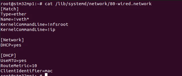

  1. Configuration: I am attempting to connect other devices, such as my smartphone and PC, wirelessly to a Wi-Fi network generated by the STM32MP157F-DK2. My current setup looks like this:
    • Smartphone (Wi-Fi hotspot) <-> [Wireless Connection] <-> STM32MP157F-DK2 (Access Point). I want just to be able to connect to the Access Point, since I want to open a webserver, and then, in the webserver in certain port, I want to write the SSID and PASSWORD credentials of another Wifi network (this network has the internet connection), basically, I want to setup my wifi credentials in a webserver, that's why I need my STMPU working as an Access Point.
  2. Access Point (AP): I am configuring the STM32MP157F-DK2 to function as an Access Point, allowing other devices to connect to it wirelessly.
  3. Environment: I am using yocto with the 5.15.67 kernel version in my development environment.
  4. This is the content of my /lib/systemd/network/51-wireless.networkobedPH_0-1693935610318.png
  5. This is the content of my /lib/systemd/network/80-wired.network obedPH_1-1693935688706.png
    Thank you very much, regards
