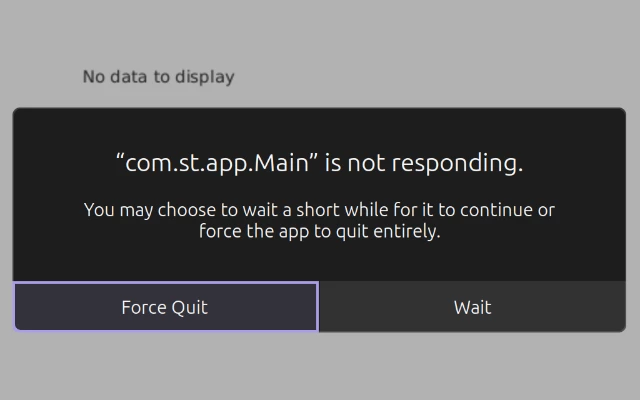

0xedbea4Author
Sep 25, 2025 8:19 PM UTC
No, the TYPEC error doesn't look to be terminal...  I can CTRL-C out of DFU mode on the device...
https://community.st.com/t5/stm32-mpus-embedded-software-and/dwc2-udc-otg-usb-otg-49000000-no-uclass-usb-typec-for-remote/td-p/728810
STM32CubeProgrammer does completely crash while trying to connect however...
I'll try the commandline
0xedbea4Author
Sep 25, 2025 8:36 PM UTC
Basically the same behaviour with STM32CubeProgrammer_CLI, but it times out gracefully.
Quirky that adding the OTG node doesn't reflect much in the uboot usb commands, but DFU does start....
