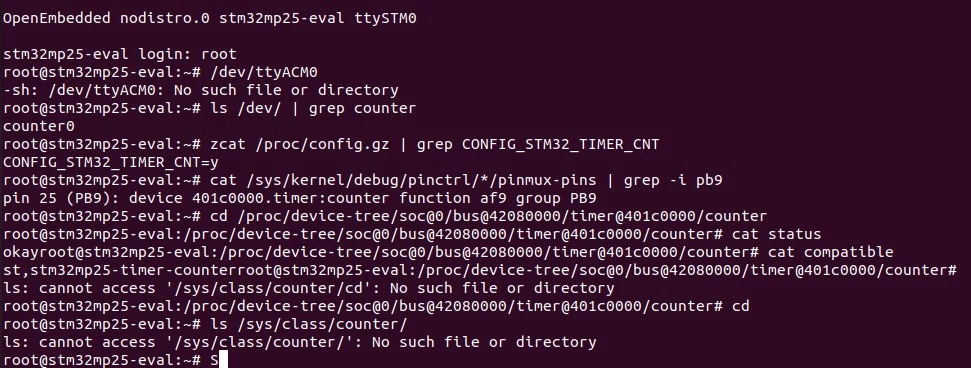

How can I enable a timer as a counter in the device tree? When checking the status using cat, the result shows 'OK', and a counter device file is created in /dev, but no corresponding counter entry appears in sysfs.
