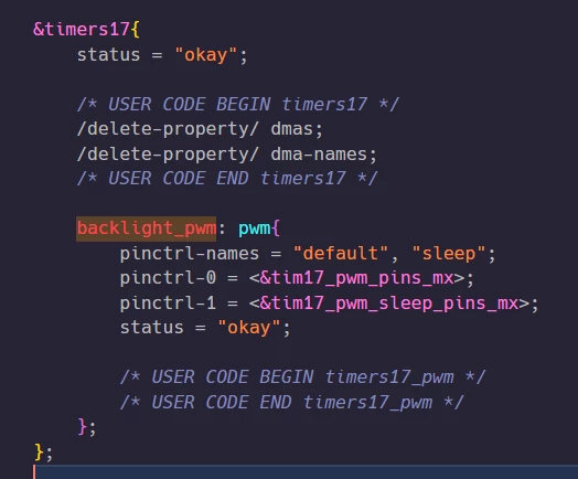

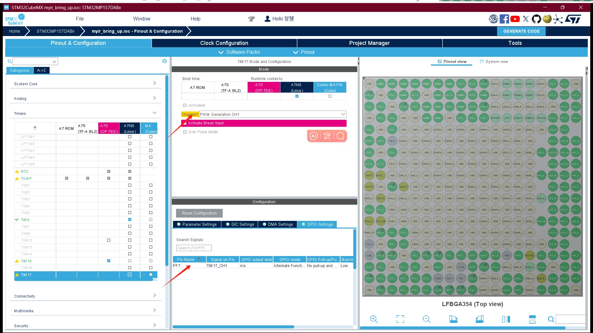

The LCD backlight pin of my board is connected to PF7, and I use the STM32CubeMX configuration as follows:
Then modify the generated device tree file to add backlight_pwm node as follows:

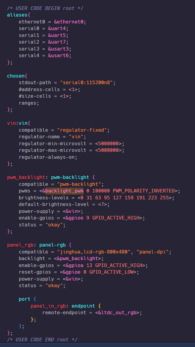

Then add pwm_backlight and panel_rgb, as shown below:

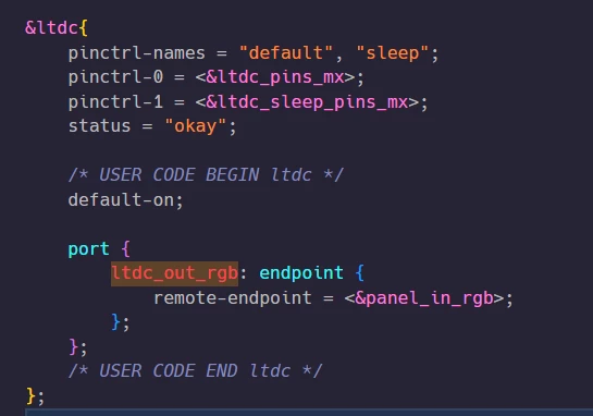

LTDC has also been modified as follows:

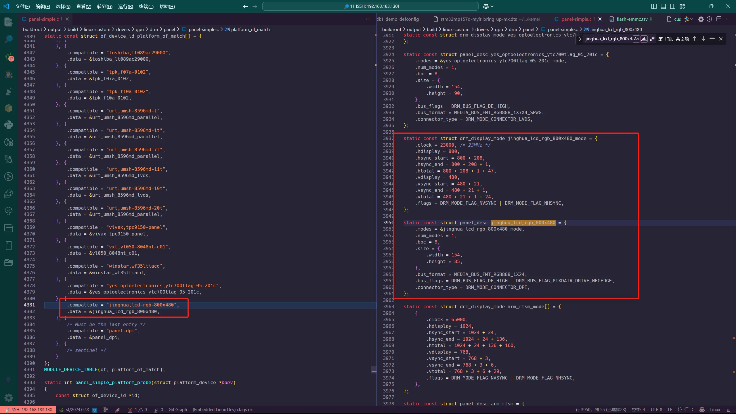

Screen parameters are written in buildroot/output/build/linux-custom/drivers/gpu/drm/panel/panel-simple.c
