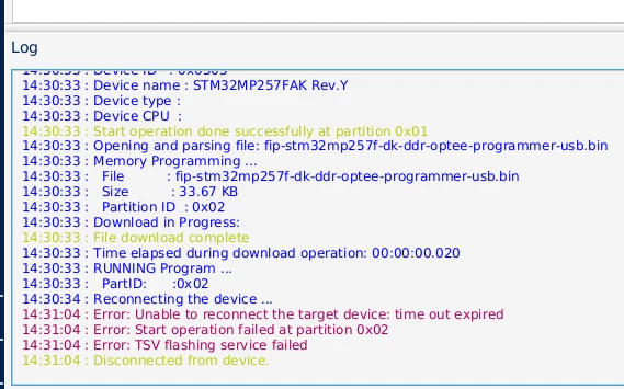

I am working on a custom board based on STM32MP267FAK3 and facing issues while flashing eMMC directly using STM32CubeProgrammer.

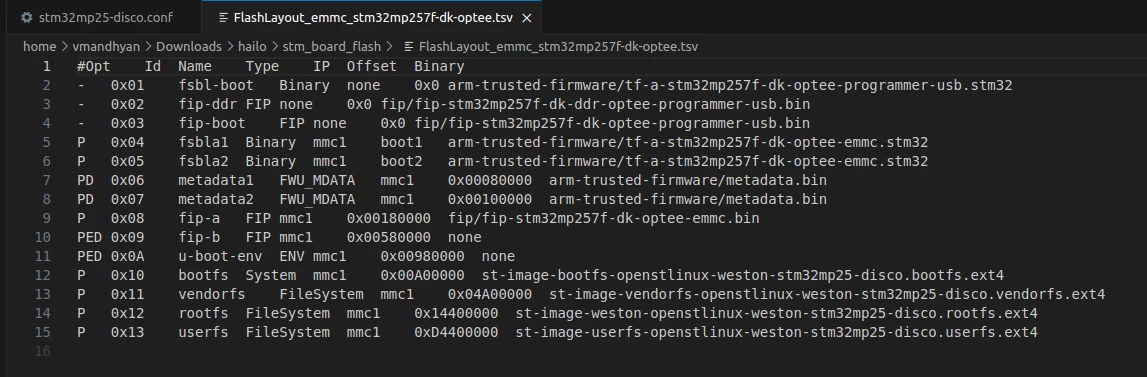

    • Using a TSV file generated from the build system (same method as reference BSP)
      TSV File
      Problem Description
      When flashing the eMMC, I consistently get a timeout error in STM32CubeProgrammer.

PatrickF
December 19, 2025
Hi, there might be two main root causes to look first:
- USB re-connection if you are using a Virtual machine. Check your VM settings or try using CubeProg under W11
- TF-A or uBoot (partition 0x1 or 0x2) is crashing (e.g. DDR init or else), please check board UART console log for error messages.
Regards.

_VanshikaAuthor
December 20, 2025
Hii,
I am not using Virtual Machine. I am using STM32CubeProgrammer for flashing.
I connected UART for checking logs this time and got the below mentioned error:

INFO:    RAM: DDR3 16bits 933000kHz
ERROR:   ddrphy_phyinit_usercustom_g_waitfwdone Training has failed.
ERROR:   DDR PHY init: Error -1
BACKTRACE: START: stm32mp2_ddr_init
0: EL3: 0xe017ba0
1: EL3: 0xe01e358
2: EL3: 0xe01ecd8
3: EL3: 0xe028a9c
4: EL3: 0xe017974
5: EL3: 0xe017ad4
6: EL3: 0xe0170e0
BACKTRACE: END: stm32mp2_ddr_init
PANIC at PC : 0x000000000e01e360
Can you tell me why this error is coming. I have done changes in dts files present in tf-a and optee for ddr and pmic settings for ddr3L at 933MHz and also the memory node for DDR which is also mentioned below:
