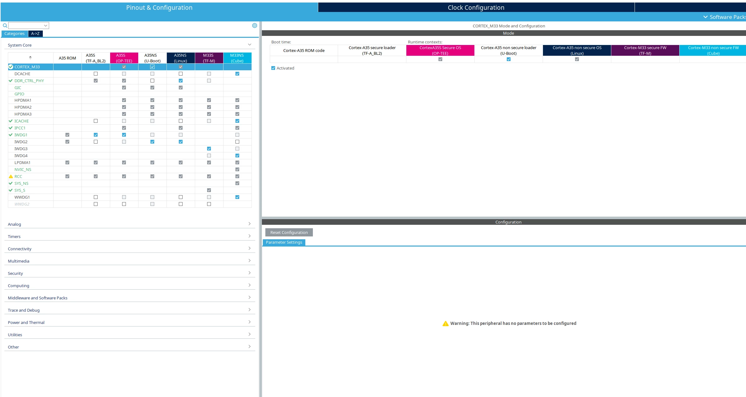

rossUAuthor
Aug 15, 2025 3:24 AM UTC
How do I disable M33 core in CubeMX project? I'm trying to untick it but the tickmark keeps going back to "Avtivated". Also I can not remove it from OP-TEE and Linux contexts, it says this peripheral is forced. When I started the project I used board selector to select EV1 board.
I did have a look into IAC and SERC errors on your wiki, I could not figure out what's going on. As I mentioned my IAC exception ID is 156 which corresponds to RCC block, and SERC exception ID is 35 which corresponds to UART5 which I removed from M33 context and added to Linux for my own needs.
