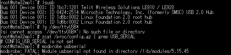

Dear ST Support Team,
I am using the STM32MP157F-DK2 evaluation board with OpenSTLinux (Linux kernel 5.15).
I am interfacing a Telit LE910C1-IN LTE modem through the USB Host interface. The modem is successfully detected by lsusb (VID:PID 1bc7:1201), and dmesg confirms successful USB enumeration. However, no /dev/ttyUSB* devices are created, preventing AT command communication.
I also verified that the kernel configuration shows:
# CONFIG_USB_SERIAL is not set
Could you please provide the recommended procedure to enable USB modem support for the Telit LE910 on STM32MP157F-DK2? Specifically, I would like to know the required kernel configuration, drivers, packages, or any additional Device Tree or software changes needed to create the /dev/ttyUSB* interfaces.
Below is relevant screenshot for reference.
Thank you.

Hello
Search for QMI in kernel menuconfig.
Or try adding these kernel configs:
CONFIG_USB_USBNET=y
CONFIG_USB_NET_QMI_WWAN=y
CONFIG_USB_WDM=y
CONFIG_USB_SERIAL=y
CONFIG_USB_SERIAL_OPTION=y
CONFIG_USB_SERIAL_WWAN=y
Add these to image recipe:
IMAGE_INSTALL += " \
networkmanager \
networkmanager-nmcli \
modemmanager \
Add networkmanager_%.bbappend to project:
PACKAGECONFIG:append = " modemmanager ppp"
or
PACKAGECONFIG_append = " modemmanager ppp"
You may have to remove networkd when adding networkmanager.
