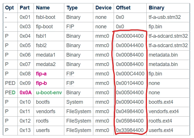

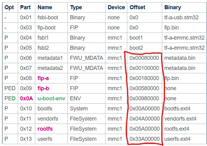

Hwang.11
Hwang.11Author
Jul 30, 2025 3:17 PM UTC
Hello ,
First of all,Thank you very much for your reply.
But I actually want to know how this offset is defined, including the offset in this header file(st-machine-storage-device-stm32mp.inc). Maybe I want to ask  , how does bootrom determine the address to load
TFA (tf-a-sdcard.stm32) from sdcard  into RAM.
I tried to modify these address and burned successfully . this mp157 can still start normally.
