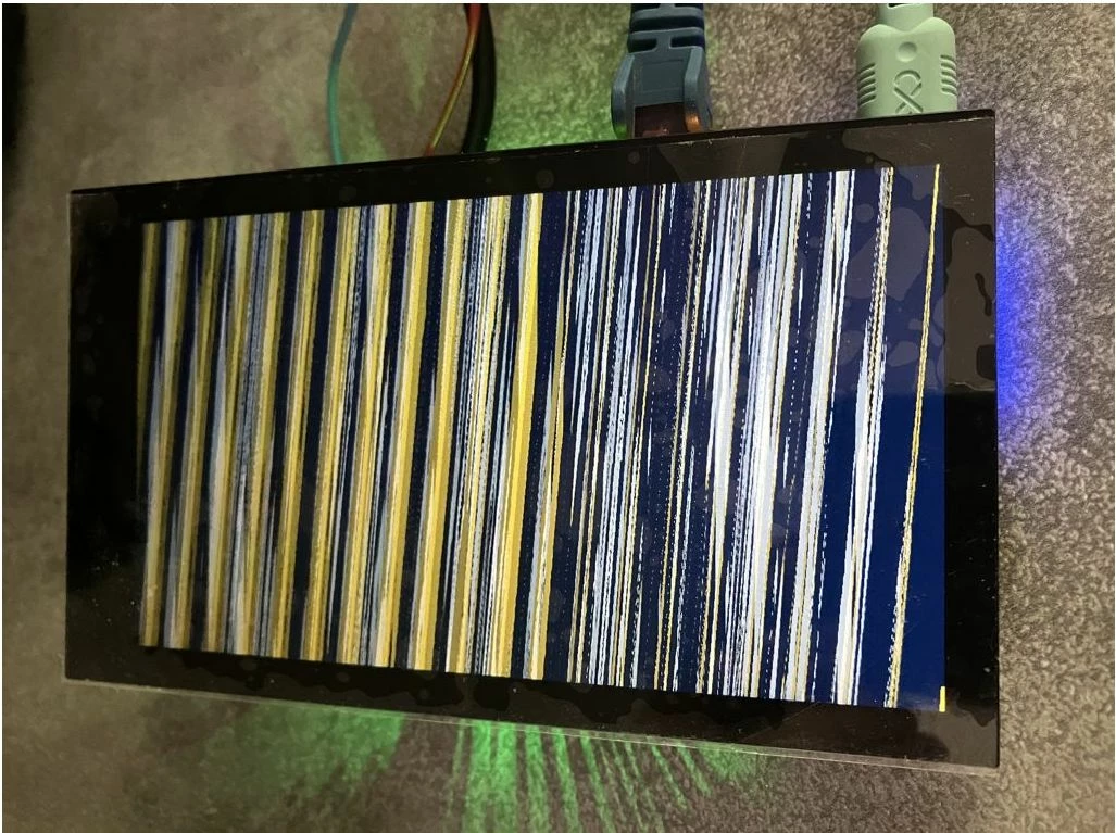

I encounter a problem with my LCD from Winstar model WF50DTYA3MNG10.
I have a custom board based on STM32MP157 with a display connected to Mipi 2 lanes.
On previous Openstlinux(kirkstone) without optee, the driver and display working well.
After switching to the latest Openstlinux I discover a problem with "ltdc fifo underrun"
root@telemach-somunknown:~# [ 96.350190] weston[1406]: memfd_create() called without MFD_EXEC or MFD_NOEXEC_SEAL set
[ 111.422211] [drm] ltdc fifo underrun: please verify display mode
[ 130.546427] [drm] ltdc fifo underrun: please verify display mode
[ 190.539247] [drm] ltdc fifo underrun: please verify display mode
[ 250.549608] [drm] ltdc fifo underrun: please verify display mode
[ 310.542950] [drm] ltdc fifo underrun: please verify display mode
[ 370.537518] [drm] ltdc fifo underrun: please verify display mode
[ 430.556994] [drm] ltdc fifo underrun: please verify display mode
Initialization seems to be without any errors

The driver is the same as the previous distro with some small alignment to the latest kernel.
Display show
According to the log suggestion, I try to apply different modes
now I check
.mode_flags = MIPI_DSI_MODE_VIDEO | MIPI_DSI_MODE_VIDEO_BURST |
MIPI_DSI_MODE_LPM | MIPI_DSI_CLOCK_NON_CONTINUOUS,
but the screen always looks as in the attached image.
I think that's not display setting a problem but probably the kernel.
What can I do with such an issue?

I've got an answer. It's simply the wrong clock configured in STMCubeMX(missing CLK_DSI_DSIPLL in st,clksrc). I checked again, set it correctly and now it's working as expected.
The topic can be closed.
