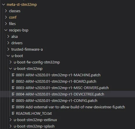

SMich.1
Senior
Sep 30, 2020 12:22 PM UTC
can you provide .patch file ? I want to see what changed.
I have the same issue, I just added stm32mp157.dtsi to includes

SMich.1
Senior
Sep 30, 2020 12:53 PM UTC
no, i see only the source files tat.gz . not the patch .
this wat i have in my Yocto layers: 0693W000004IFQBQA4.jpg
do i need to update the layers from git source?
Olivier GALLIEN
Sep 30, 2020 1:25 PM UTC
Hi @SMich.1​
In order to integrate the u-boot hot-fix in Github in your Ditribution environnement please refer to instruction here :
https://wiki.st.com/stm32mpu/wiki/STM32MP15_OpenSTLinux_release_note#Minor_release_updates
Olivier
SMich.1
Senior
Sep 30, 2020 1:52 PM UTC
tnx, i have one more question,
If i going through Distribution package installation guide in wiki pages the last minor hot-fixes will be applied?
Olivier GALLIEN
Oct 5, 2020 1:05 PM UTC
Hi @SMich.1​ ,
No minor hot-fixes release in BSP components are not integrated in Distribution package.
You need to follow instruction in https://wiki.st.com/stm32mpu/wiki/STM32MP15_OpenSTLinux_release_note#Minor_release_updates.
Olivier
SMich.1
Senior
Oct 10, 2020 1:14 PM UTC
so the tag that fixes this issue is this: v2020.10-rc5 ?
Olivier GALLIEN
Oct 26, 2020 2:51 PM UTC
Hi @SMich.1​
Sorry for late reply and error in my communication.
Actually v2020.10-rc5 was a wrong reference.
There is no hotfix tag available for this fix on github.
We will integrate it only in next major release.
So you need to apply manually the patch shared in my first comment.
Olivier
