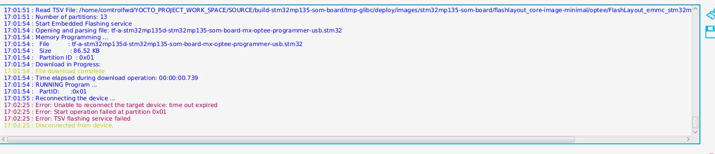

However, when I try to program the board using STM32CubeProgrammer in USB DFU mode, CubeProgrammer reports that it cannot reconnect to the device.
I also connected a serial terminal to the debug UART. During the boot/programming sequence, I see:
PANIC at PC : 0x2ffe6405
Exception mode=0x00000016 at: 0x2ffe6405
The relevant CubeMX-generated DTS files, machine `.conf`, and `local.conf` are attached below.
Could someone please help me identify what could cause the: PANIC at PC : 0x2ffe6405
Exception mode=0x00000016. and why CubeProgrammer subsequently reports that it cannot reconnect?
Also, what would be the recommended procedure to debug this on a custom STM32MP135DAF + eMMC board?
Any suggestions or debugging steps would be greatly appreciated.
Thank you.
cube programmer error
