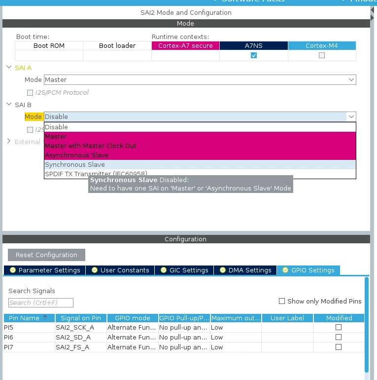

STM32MP1 how to configure SAI2 B as slave (greyed out option in cubeMX)
  • August 4, 2020
  • 3 replies
  • 2239 views
If I configure SAI 2 in cubeMX I get a greyed out option that the synchronous slave is not available unless I have one SAI as master, but I have set SAI A as master (or master with master clock out). So what am I doing wrong?
It doesn't matter if I configure it for the A7NS or the cortex-m4, the option is greyed out.
The pins are available for both the SAI2 A/B0693W000003C59TQAS.jpg
Is this a limitation of cubeMX? Or am I missing something?
Thanks, Robert

Hello RZ,
Thanks for your feedback, the issue is reproduced. It will be reported internally for review and correction.

Hi @RZ​ ,
As the problem seems to come from STM32CubeMX, I suggest you to mux your pins manually in the Device Tree.
This link might be useful : https://wiki.st.com/stm32mpu-ecosystem-v1/wiki/SAI_device_tree_configuration

August 5, 2020
Thanks Armand, that was what I was looking for. RZ
