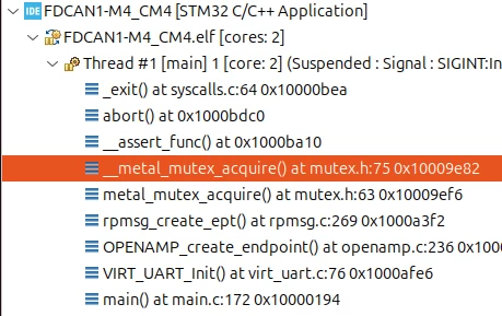

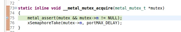

ST32MP157F-DK2 CM4 project fails on VIRT_UART_Init
  • July 23, 2025
  • 425 views
I generated a project from a ioc f
ile that I created. I'm getting this assert error in
2 replies

smangerAuthor
August 8, 2025
I think this was happening because the M4 project was build with an IOC file that is different from the Starter Image, so the memory regions do align properly. I can flash LEDs with that code, but when I try to use OPENamp, the program crashes.
I didn't realize this at first. So, I think this will go away once I can build and deploy the A7 that is built from my IOC file, That is still my major concern! I still can not do that and my online support case has yielded absolutely nothing. I'm update to update that because I tried another process listed in the forum. And that doesn't work either.
