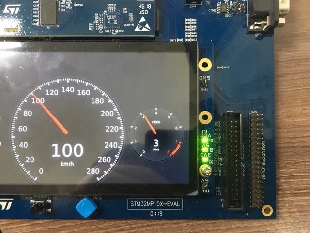

I am Korean and a developer with less than a year of experience. Please understand the immaturity of inquiring in the official English language. I am using STM32MP157C-EV1 board. The board has the following settings according to the blog link I referenced. The blog link address is : " http://www.emsyslabs.com/how-to-compile-linux-using-yocto-for-stm32mp1/ ". As you can see, the settings are as follows.
STM32MP157C-EV1
*Linux Image : OpenSTLinux -> st-example-image-qt
*DISTRO=openstlinux-eglfs MACHINE=stm32mp1 source layers/meta-st/scripts/envsetup.sh
As you see the anothe address link : https://wiki.st.com/stm32mpu/wiki/OpenSTLinux_distribution
"Image : st-example-image-qt is ST example of image based on QT framework "
That's right. I'm doing some development to test a Qt example on that STM32MP157C-EV1 Board. Luckily, referring to the blog link, I was able to test the qt example for the target board, including the toolchain.

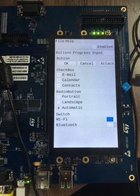

But I'm having a hard time. When running the Qt example, it is running in portrait mode only, not landscape mode. How can I run the Qt example in landscape mode? To run in landscape mode, I tried two things.
One thing is the referring to the previous blog, image file created on the basis of eglfs. Modified the profile file in the embedded Linux /etc directory.
As follows in Bold

Second, I modified the qml file in the qtquick example. In the dashboard Qt example, I added the following x, y, and angle values:
Window {
   visible: true
   width: 1280/2
   height: 720/2
   color: "#161616"
   title: "Qt Quick Extras Demo"
   ValueSource {
   Item {
       width: root.width
       height: root.height
       anchors.centerIn: parent
       transform : Rotation {
           origin.x: 420
           origin.y: 610
           angle:270
The first method was useless. The second method was displayed in landscape view as shown in the following image.
Again, I would like to ask you some great professionals here. How can I run the qt example in landscape mode? For more fundamental solution. Same thing as modifying the kernel. Like the kernel fix code below. CONFIG_FRAMEBUFFER_CONSOLE_ROTATION=y fbcon=rotate:3
However, I did not find it on st-image-qt. Even though I typed the following command: cd / && grep -r "CONFIG_FRAMEBUFFER_CONSOLE_ROTATION" /
That is all. Thank you.
