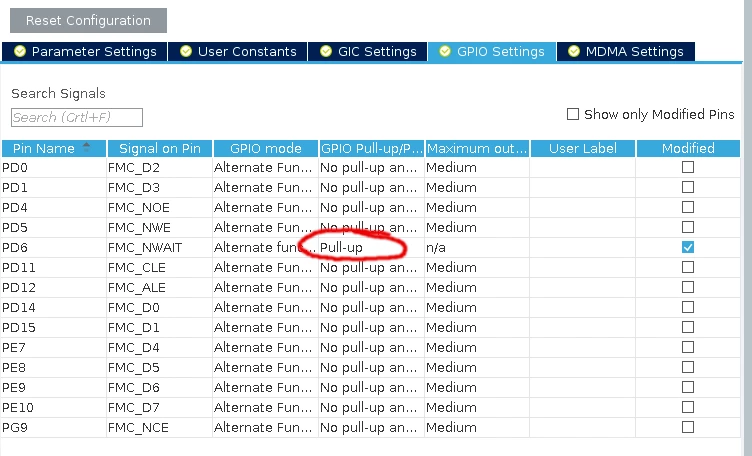

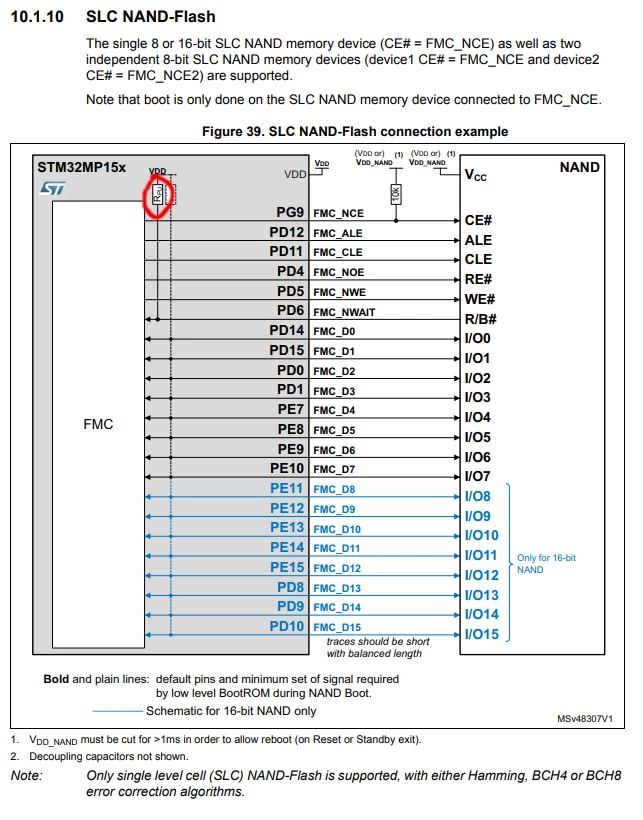

Well, after much debugging and comparing DT source files with other boards, we have found the problem. And it was quite a silly problem.
The default pin config from CubeMX does not enable the internal pull-up resistor on the FMC_NWAIT pin. In the getting started guide section 10.1.10 it's hinted at:
https://www.st.com/content/ccc/resource/technical/document/application_note/group1/b7/b5/ca/8e/93/20/42/0e/DM00389996/files/DM00389996.pdf/jcr:content/translations/en.DM00389996.pdf
So a heads up: Make sure you enable this option:
Or set bias-pull-up; in the DT source:

 pins2 {
 u-boot,dm-pre-reloc;
 pinmux = <STM32_PINMUX('D', 6, AF12)>; /* FMC_NWAIT */
 bias-pull-up;
Why the R/W addresses and chip counts are still 0 is unknown. Apparently that's ok?
