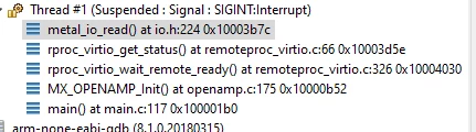

M4 freezing when initializing OpenAMP
I am working on developing firmware to run on the M4 coprocessor and I have been trying to do some basic testing using my own code and the OpenAMP_TTY_Echo example. I am debugging on an stm32mp157c-dk1 and I am using STM32CubeIDE. This issue is also occurring on a dk2. I noticed that it freezes after the function call
MX_OPENAMP_Init(RPMSG_REMOTE,NULL);
Here is the call stack:
My issue appears to be identical to this issue posted a while back. I don't have the "PeriphCommonClock_Config" function mentioned and I am unable to remove rsc_table.c as openamp.c depends on it. Additionally the project by default includes STM32MP157CXX in the preprocessor directives, so I am unsure of what else I can do to alleviate this issue. Is it an issue that I am in engineering boot mode?
Any guidance would be greatly appreciated.

Hi @DShul.2​ ,
Thanks to raise this point.
We are suspecting a regression somewhere since MX_OPENAMP_Init(RPMSG_REMOTE,NULL); not supposed to be blocking in Engi mode.
Anyway this function is useless in this mode and can be easily ignore by putting it under flags like this :
 if (!IS_ENGINEERING_BOOT_MODE())
   MX_OPENAMP_Init(RPMSG_REMOTE, NULL);
This might surely unlock you.
I'll come back for update vs possible regression.
Olivier
EDIT : typo in initial comment. Test should be IF NOT IS_ENGINEERING_BOOT_MODE
