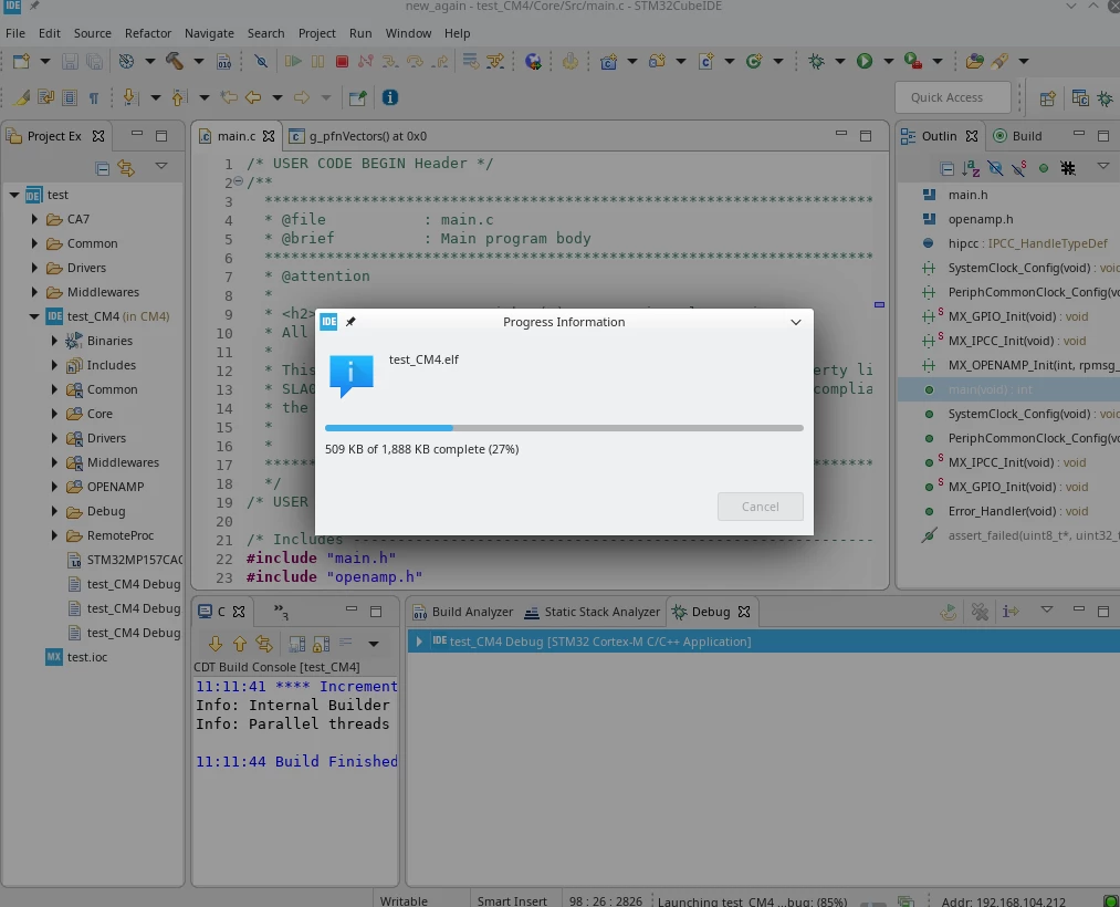

M4 ELF build done in CUBEIDE is not uploaded to target on dunfell platform
The program can not be uploaded under the dunfell distribution via CUBEIDE 1.3.1 to the target system. Using the thud distribution, target uploads works.
Are there any hidden upload scripts in the CUBEIDE - how to debug the debug upload?
Which yocto packages are necessary to cooperate with the CUBEIDE?

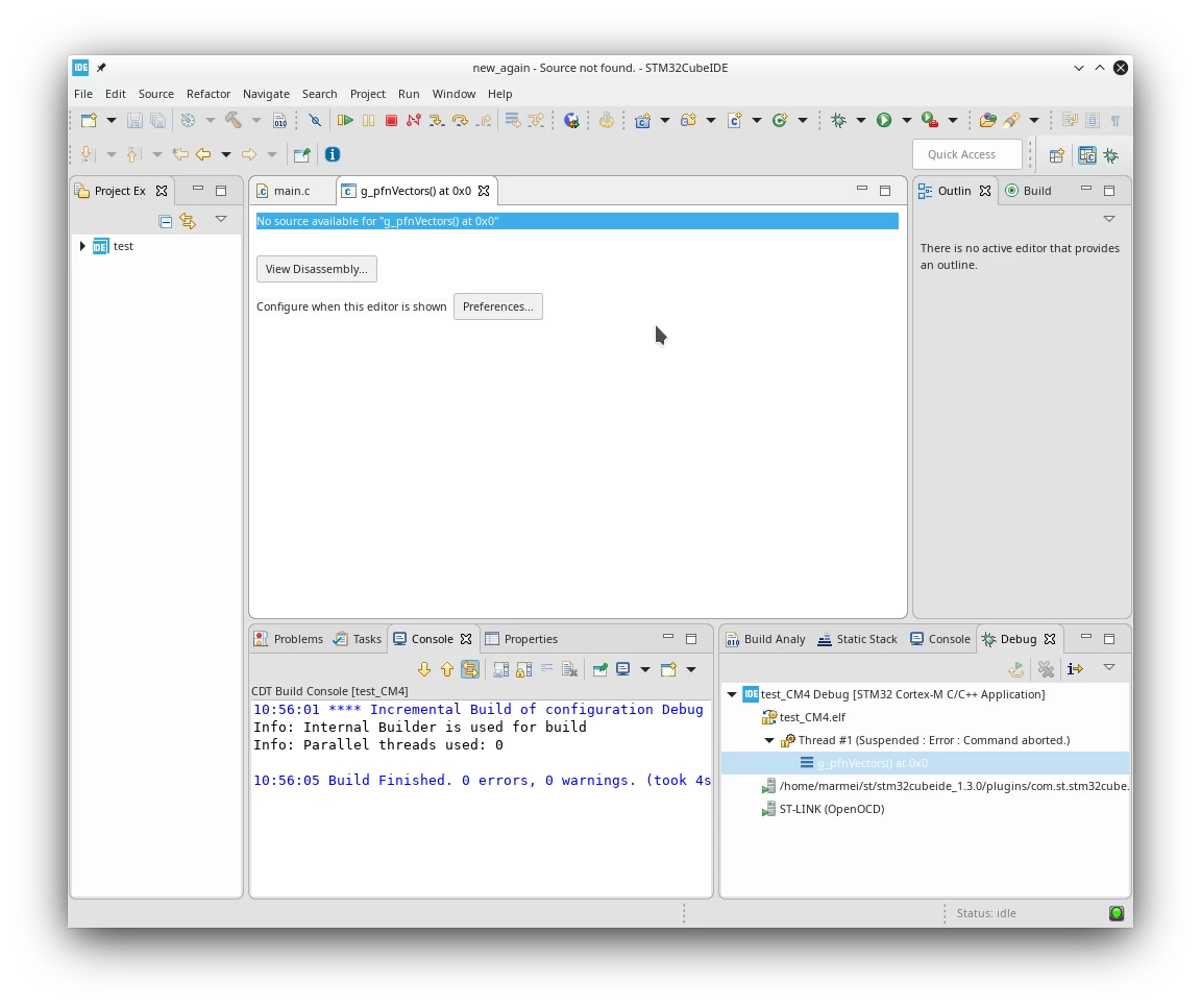

OlivierK
OlivierKBest answer
Jul 17, 2020 2:32 PM UTC
​The fix is now published.
https://wiki.st.com/stm32mpu/wiki/STM32MP15_ecosystem_release_note_-_v2.0.0
https://wiki.st.com/stm32mpu/wiki/STM32MP15_OpenSTLinux_release_note_-_v2.0.0
some cipher methods have been disabled by the community for security reasons.
As a consequence some ssh requests from STM32CubeIDE may not be functional due to the dropbear package configuration.
In this case, you can either:
Best Regards,
Olivier

When looking in the /lib/firmware directory on the target, there is no uploaded elf file.
If I upload it by hand, load it into the co-processor, gdb seems to connect.
It is mainly because of the target upload.
On the thud distribution running on the target, the "Uploading to target process indication" flops up. This did not happen using my built using the dunfell distribution.
Is the CUBEIDE uploading via ssh scp?

Messages on the CubeIDE is:
I am using ethernet via a different network, DHCP.
However for the thud build, I am using the same ethernet setup and it worked.
No source available for "g_pfnVectors() at 0x0"
It seems there were no shell commands executed on the target.

Jul 9, 2020 9:14 AM UTC
This is confusing me. What do you mean ?
This is the process indicator when using the the thud build on the target.
On dunfell I do not get so far. - Same network configuration, CUBEIDE was not restarted after target upload failure on the dunfell built.
