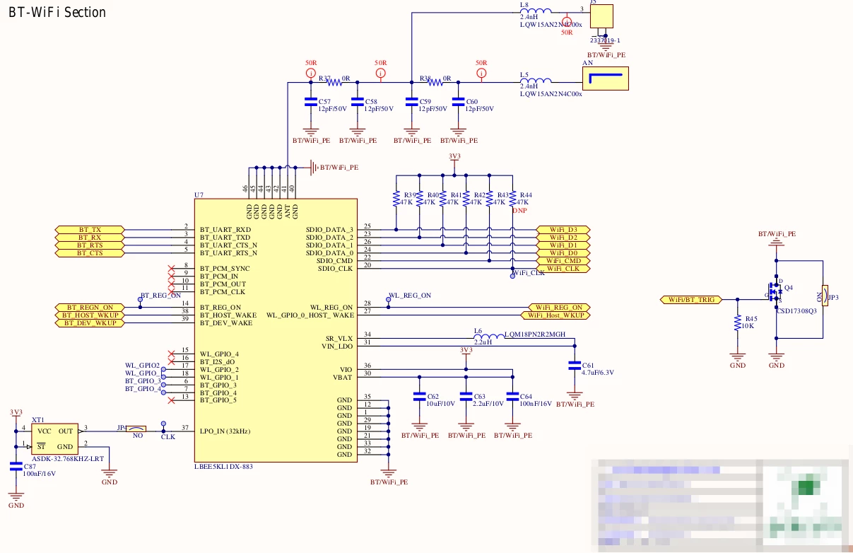

LBEE5KL1DX-883 issue with SDMMC3
Hi.. there
Hope all are doing well
We have designed our own custom board by taking the reference of the DK2 board, in which we're using the LBEE5KL1DX-883 WiFi/BT module from Murata at SDMMC3
somehow, the module is unable to detect!
after dmesg of the MMC log, I got to know that the SDMMC 3 is not initialized
here is the mmc dmesg logs

From the logs snipped you can see that the mmc initialization is failed with error code 22 !
My DTS file configuration is shown at below
/* WiFi node */
&sdmmc3 {
 arm,primecell-periphid = <0x10153180>;
 pinctrl-names = "default", "opendrain", "sleep";
 pinctrl-0 = <&sdmmc3_pins_mx>;
 pinctrl-1 = <&sdmmc3_opendrain_pins_mx>;
 pinctrl-2 = <&sdmmc3_sleep_pins_mx>;
 non-removable;
 st,neg-edge;
 bus-width = <4>;
 vmmc-supply = <&v3v3>;
 mmc-pwrseq = <&wifi_pwrseq>;
 #address-cells = <1>;
 #size-cells = <0>;
 status = "okay";
 brcmf: bcrmf@1 {
 reg = <1>;
 compatible = "brcm,bcm4329-fmac";
	/* WiFi power ON Sequance from device driver */
	wifi_pwrseq:wifi-pwrseq{
		compatible = "mmc-pwrseq-simple";
		reset-gpios = <&gpioh 4 GPIO_ACTIVE_LOW>; /* WL_REG_ON -> PH4 */
right now, I'm deleing with the older BSP without TF-A (4.19.49)
Do I need to set the clock at uboot also?
Can anyone redirect me towards a right solution?
Thanks

Olivier GALLIEN
Jul 12, 2021 3:21 PM UTC
Hi @Mahendra Sondagar​ ,
Did you check you HW by confirming the module is powered and clocked ?
Else could you clarify what you mean by "I'm deleing with the older BSP without TF-A (4.19.49)"
particularly "without TF-A" ? Should I understand Uboot-SPL for so called ( and deprecated) basic boot ?
Else 4.19 is the kernel version of a quite old ecosystem.
Since you are at bring-up level why don't you use the more recent DV3.0 ?
If your design is really a duplication of DK2, the provided BSP might work almost as is.
Olivier
Mahendra Sondagar
Jul 13, 2021 7:53 AM UTC
Hi.. @Community member​
Thanks for your feedback
I'm using a 32.768khz external oscillator with my custom board
yes, the board is clocked well, as I have confirmed with the analyzer
I have also confirmed the high to low transaction of the WL_REG pin during the boot time
My kernel version is 4.19.49 without TF-A. it means I have zImage, uboot+spl & rootfs only
yes, you're right it's an older one
But, right now I'm intended to test my application on the existing BSP which I got from my SOM manufacturer because of some strict timeline of the project
here I have attached the screen-shot of the WiFi section of my custom board schematic
Note: WiFi_BT trigger load trigger MOSFET is short at the moment
Thanks & Regards
Mahendra
Olivier GALLIEN
Jul 13, 2021 9:50 AM UTC
First, I kindly warn you that ST is no longer supporting solution based on DV1.2 ( kernel 4.19) moreover using the basic boot which is a non sustainable solution for product development.
If your SOM Maker still provide such solution it's under his responsibility, and it's duty to support you.
This said, I just realized I forgot to ask if you properly enable SDMMC3 kernel clock in U-Boot DT.
You should have in rcc node "st,pkcs" property something like CLK_SDMMC3_PLL4P
Olivier
Mahendra Sondagar
Jul 13, 2021 10:14 AM UTC
yes, I understood
The SOM design is adopted by taking reference to the DK2 board (except PMIC section)
very soon, I'm going to customize the latest OpenST environment as per our custom board's needs
But for now, I'm looking for the WiFi to be working with the current Linux environment which I have
yes, CLK_SDMMC3_PLL4P is there in uboot DT
