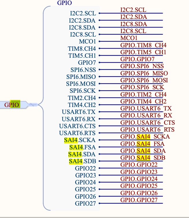

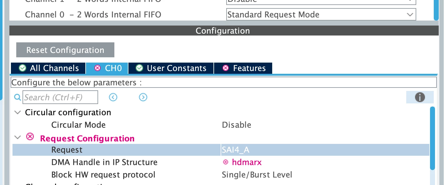

ok ,First, let me clarify: I’m using SAI4 on the STM32MP257F-DK Discovery Kit. According to the board schematic, SAI4 is routed to the GPIO expansion connector, where it connects to my external ADC.
My goal is to configure SAI4 as a Slave, with my external ADC acting as the Master. Using Frame mode, I want the M33 core to use DMA to transfer the ADC data into a large shared memory buffer accessible by the A35 core. The A35 will then handle all subsequent processing of the ADC data.
