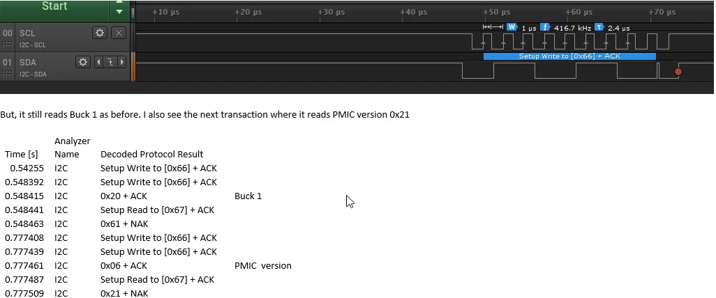

Last night we traced the output on the I2C and the driver is clearly talking coherently to the PMIC:
There is no reason why it is stopping after just the BUCK1 test. It conforms to the configuration file requirements, so that test should pass, and it should move on to BUCK2, but it does not.
We are using https://github.com/STMicroelectronics/arm-trusted-firmware/tree/v2.2-stm32mp/drivers/st/pmic that is 5months old, however there is a patch file that is applied to this and we believe the patch file has a bug or something. While it is difficult to look at the patch file and see what changed, one thing is very clear that the enumeration-loop of the different regulators has been re-organized significantly. I wish there was a way to look at the post-patch pmic.c file so we could follow the new logic of node-by-node PMIC enumeration! (do you know a way of seeing the post-patch source file?). But clearly something in this code was changed significantly and is not working.
We are dead in the water here until we get some support on what is going on in the post-patch pmic.c. Our hardware and config look very clean, so we are at a loss what to do next.
