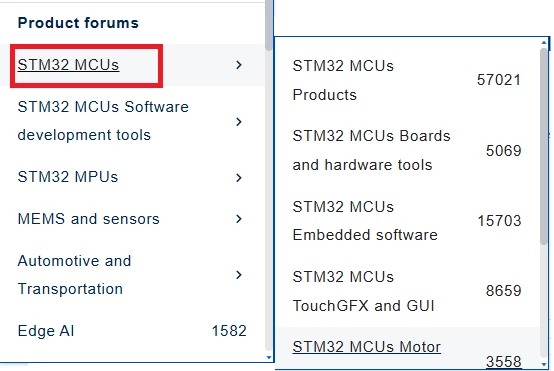

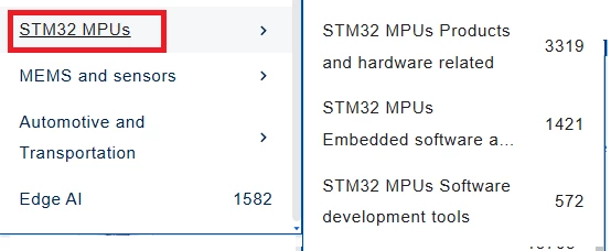

Hello ​@balasaivura and welcome to the ST community,
I’m posting here as a community admin.
You are asking the same question for totally different platforms: MCU (STM32N6) which a microcontroller and MPU (STM32MP2) which is a microprocessor.
There are two different forums for MCUs and MPUs:
For MCUs:
For MPUs:
So what I suggest is to dedicate one post for each product.
Thank you for your understanding.
