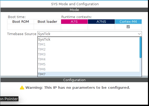

I wish use FreeRTOS with STM32MP157C. When I configure my bord on CubeMX a message pop up says I should configure SYS parameter with an others time source than sysTick. But if I configure TIM1 for example I cannot assign TIM1 in SYS section .
card
Have you any ideas to solve this problem ?

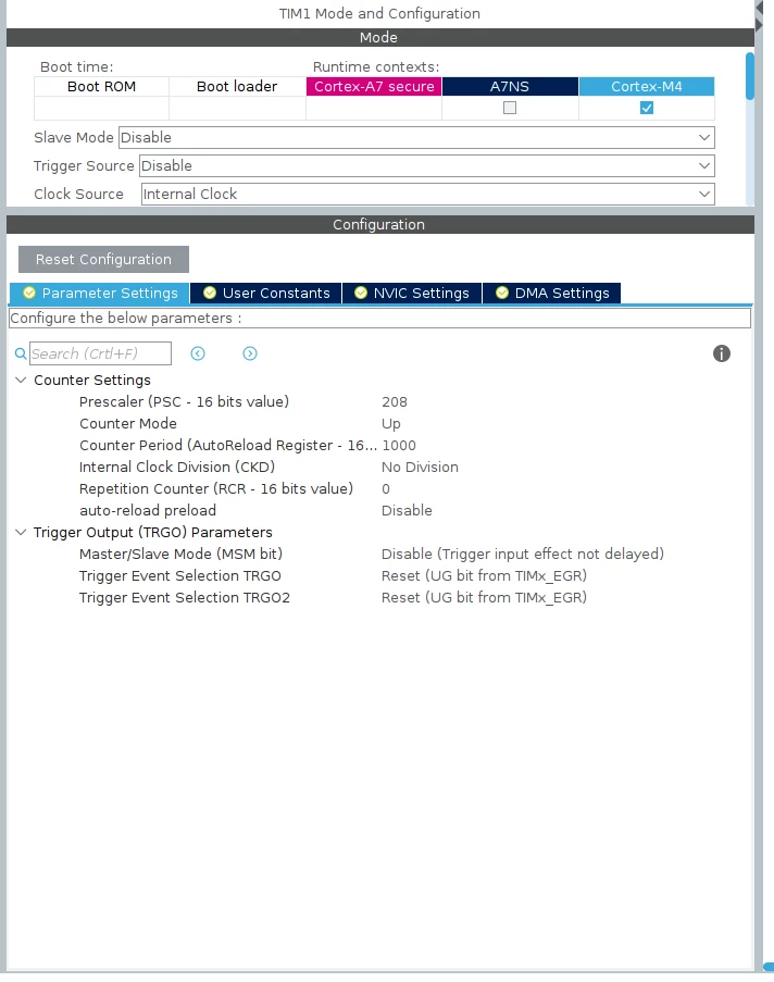

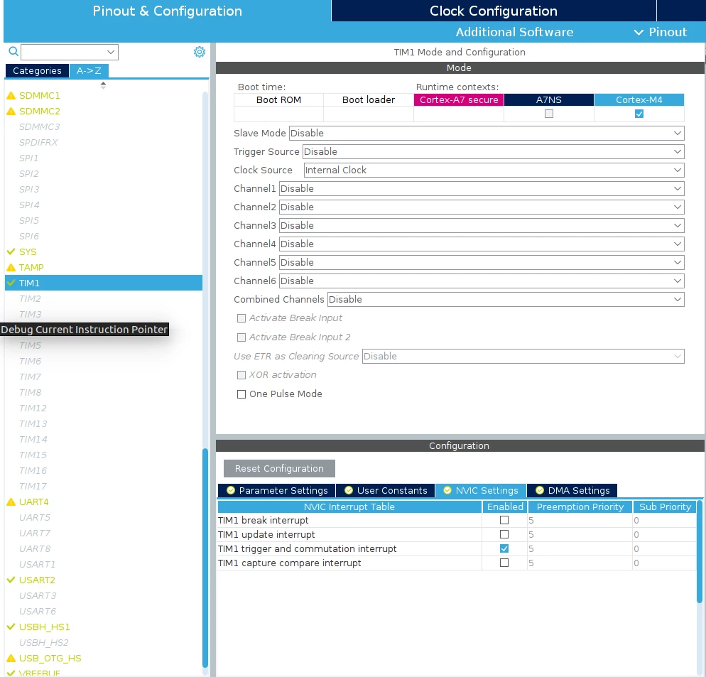

ABous.1
ABous.1Author
January 31, 2020
I try again with your recommendation but without success.
I do some screenshot of my modification in cubeMX project.
PS: My STMcubeMX version is 5.5.0.
Best regards,
Arnaud Bousquet0690X00000BxAhRQAV.png0690X00000BxAhMQAV.png0690X00000BxAhHQAV.png
Olivier GALLIEN
January 31, 2020
Hi @ABous.1​
You have to remove Clock Source setting in TIM1. Set it back to Disable.
Olivier
