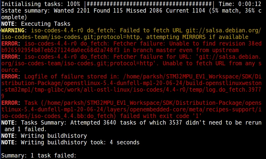

How can i solve iso-codes-4.4-r0 do fetch error?(I proceeded according to the procedures of the WIKI Page. : https://wiki.st.com/stm32mpu/wiki/STM32MP1_Distribution_Package)
0693W000001sHz8QAE.pngHello guys.
​I am proceeding in the manner provided on the WIKI page(https://wiki.st.com/stm32mpu/wiki/STM32MP1_Distribution_Package).
However, the following problems still occur in Step 6.
[error codes]
WARNING: iso-codes-4.4-r0 do_fetch: Failed to fetch URL git://salsa.debian.org/iso-codes-team/iso-codes.git;protocol=http, attempting MIRRORS if available
ERROR: iso-codes-4.4-r0 do_fetch: Fetcher failure: Unable to find revision 38edb926592954b87eb527124da0ec68d2a748f3 in branch master even from upstream
ERROR: iso-codes-4.4-r0 do_fetch: Fetcher failure for URL: 'git://salsa.debian.org/iso-codes-team/iso-codes.git;protocol=http'. Unable to fetch URL from any source.
ERROR: Logfile of failure stored in: /home/parksh/STM32MPU_EV1_Workspace/SDK/Distribution-Package/openstlinux-5.4-dunfell-mp1-20-06-24/build-openstlinuxweston-stm32mp1/tmp-glibc/work/all-ostl-linux/iso-codes/4.4-r0/temp/log.do_fetch.39779
ERROR: Task (/home/parksh/STM32MPU_EV1_Workspace/SDK/Distribution-Package/openstlinux-5.4-dunfell-mp1-20-06-24/layers/openembedded-core/meta/recipes-support/iso-codes/iso-codes_4.4.bb:do_fetch) failed with exit code '1'
I think there is a problem with that brench(do_fetch).
(I don't see the corresponding brench on the iso-codes page.)
How do I solve this problem?
The contents of log_do_fetch are uploaded as attachments.
thanks

Hi @SPark.15​ ,
Can you make sure you did all the prerequisites concerning the distribution package ?
https://wiki.st.com/stm32mpu-ecosystem-v1/wiki/PC_prerequisites
Is it the first time you are trying to bitbake ?
Regards,
Armand

Hi @SPark.15​ ,
Fetch errors are recurrent and may occur due to some network issues.
I suggest you to launch it again (or to source again the envsetup.sh file in another shell). Tasks already run are normally saved so you will not restart from scratch.
Best regards,
Armand

Hi ArmandG (ST Employee)
Thanks for your answer.
I tried again the way you suggested. But still, the same problem only occurs in iso-codes.
I tried about 20 more times, but it's still the same.
Is there any way other than trying again?
