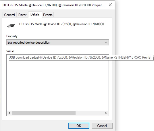

PatrickF
Apr 14, 2021 10:13 AM UTC
in W10 Device Manager, please check the USB 'DFU in HS mode @...." device properties details.
Property 'Bus reported device description' should be:
  1. "DFU in HS Mode @Device ID /0x500, @Revision ID /0x0000" when it is issued from the BootROM (used to load partition Id 0x01 and 0x03) after reset with BOOT pin set to 'Serial USB'
  2. "USB download gadget@Device ID /0x500, @Revision ID /0x2000, @Name /STM32MP157AAC Rev.B," or similar when uBoot is connected (after "Reconnecting the device ..." )
If not, you might have missed some USB driver during installation or some USB devices are disabled (e.g. still point to a Virtual Machine).
Be sure to try with latest CubeProgrammer v2.7.0 and pre-built images from latest Starter Package.
Logging console could help (UART VCP on ST-Link port, 115200,n,8,1)
Regards.

PatrickF
Apr 14, 2021 11:58 AM UTC
Please carefully check the property 'Bus reported device description' for point 1 and 2 in my previous reply
When uBoot start, it should be like that (captured from DK2-F):0693W000008zWg3QAE.pngyou could also use:
"%ProgramFiles%\STMicroelectronics\STM32Cube\STM32CubeProgrammer\bin\STM32_Programmer_CLI.exe" -l usb
and check "Product ID" before flashing (with BootROM DFU) and during Flashing (with uBoot DFU).
Have your tried on another PC or using another USB high-speed port on the PC ?
