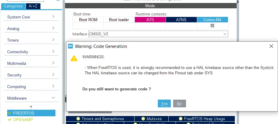

In this days I'm starting to understand and try the M4 core in DK2 evk, following the wiki i'm able to use it. Now I would like to create a new project from zero, but I have a small problem.

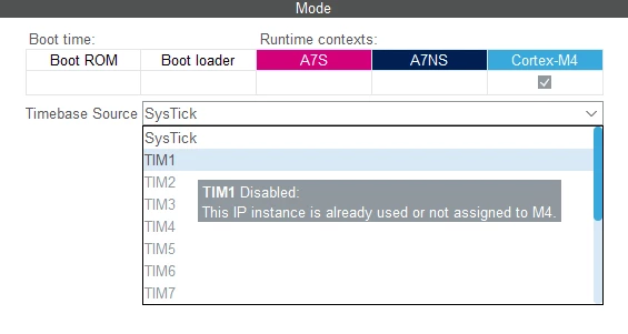

If I start new project in CubeMX, I can enable freertos but if I try to generete code i have the follow alert:
Ok, i can try to change the TIMEBASE Source but is not possible (seems in use):
Can someone help me?

You have to assign a TIMx to M4 context but without enabling it.
It will be available as time source then.

You probably need to enable TIMx in the "Timers" peripheral section before you can use it as a time source.

No, I tried, but the "Timebase source" remains blocked.

Hi @Community member​  and @TDK​ ,
thanks for your support! It seems working!
