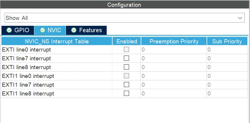

Dear all,
I was trying to setup the NVIC for EXTI for certain pins on STM32MP257F over CubeMX. However the nomenclature in CubeMX confuses me a lot. As I know there are two EXTIs: EXTI1 and EXTI2 which completely changes when we look into NVIC there it shows EXTI and EXTI1. Now the confusion is if EXTI is EXTI1 or 2 and so on.

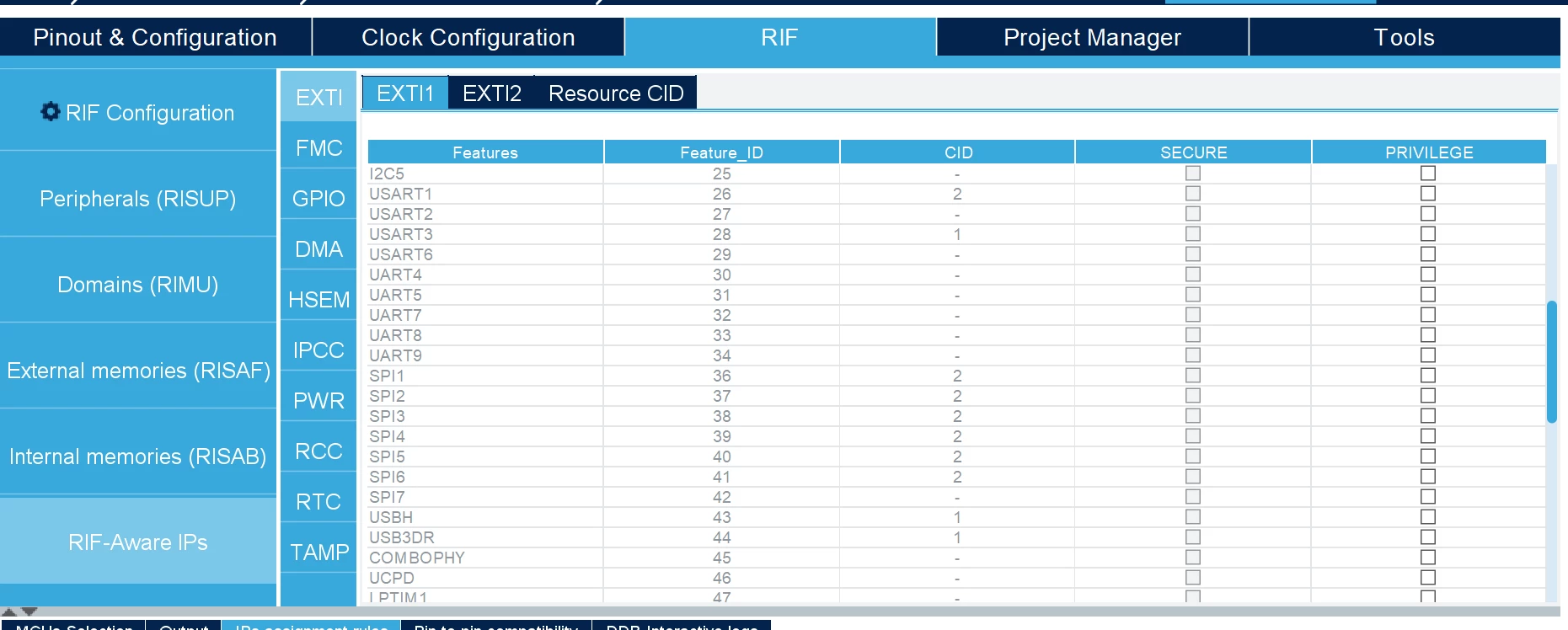

Amit_RSAuthor
Mar 27, 2026 8:06 AM UTC
Hi @PatrickF ,
I looked through the reference manual, however it doesn't mention why assigning GPIOs to EXTI open up two EXTI instances i.e EXTI and EXTI1. Also I couldn't find information on what is the difference between them. If you see my first image there you can clearly see EXTI line 7 interrupt and EXTI1 line 7 interrupt. So it completely confuses me as RM never mentions it.

PatrickF
Mar 27, 2026 8:17 AM UTC
Agreed, it is confusing. I could guess 'EXTI' is EXTI2.
I confirm you could assign a GPIO to either EXTI1 or EXTI2 (or both, but useless).
Maybe looking at generated code could help to clarify.
