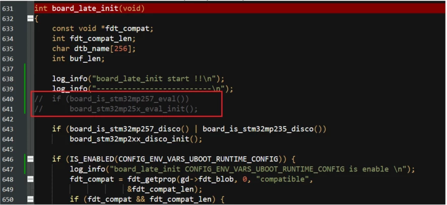

Hi @Erwan SZYMANSKI ,
After modified the u-boot board driver stm32mp2.c, the backlight could be enabled.
The main modification is to remove the part that determines whether the panel with stm32mp25 preset support is detected.
I'm not sure if this modification is reasonable. Please help clarify it. Thank you.

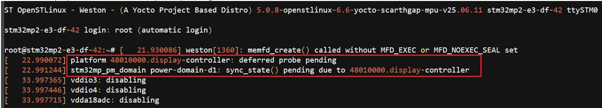

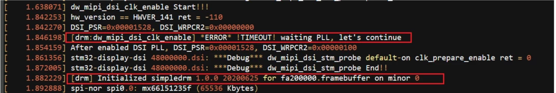

I attached kernel dmesg log. The panel is detected as connected, but there's still no image and the backlight flickers.
Observing the log, I find the PLL timing issue on dw_mipi_dsi_clk_enable function.
In addition, it seems that ltdc will probe pending, I don’t know if it is caused by clock problem.
48010000.display-controller: deferred probe pending
I used the command to cat more drm information, you can refer the attached files.
Thank for your help.

Tim_hoAuthor
September 3, 2025
I tried to remove  "default-on" property in Linux device tree under dsi node,  PLL timing issue could be resolved.
I also activate DSI node in u-boot device tree, the panel can bring up on u-boot. But the panel will disable when boot into kernel level.
Do you have any idea?
Thanks.

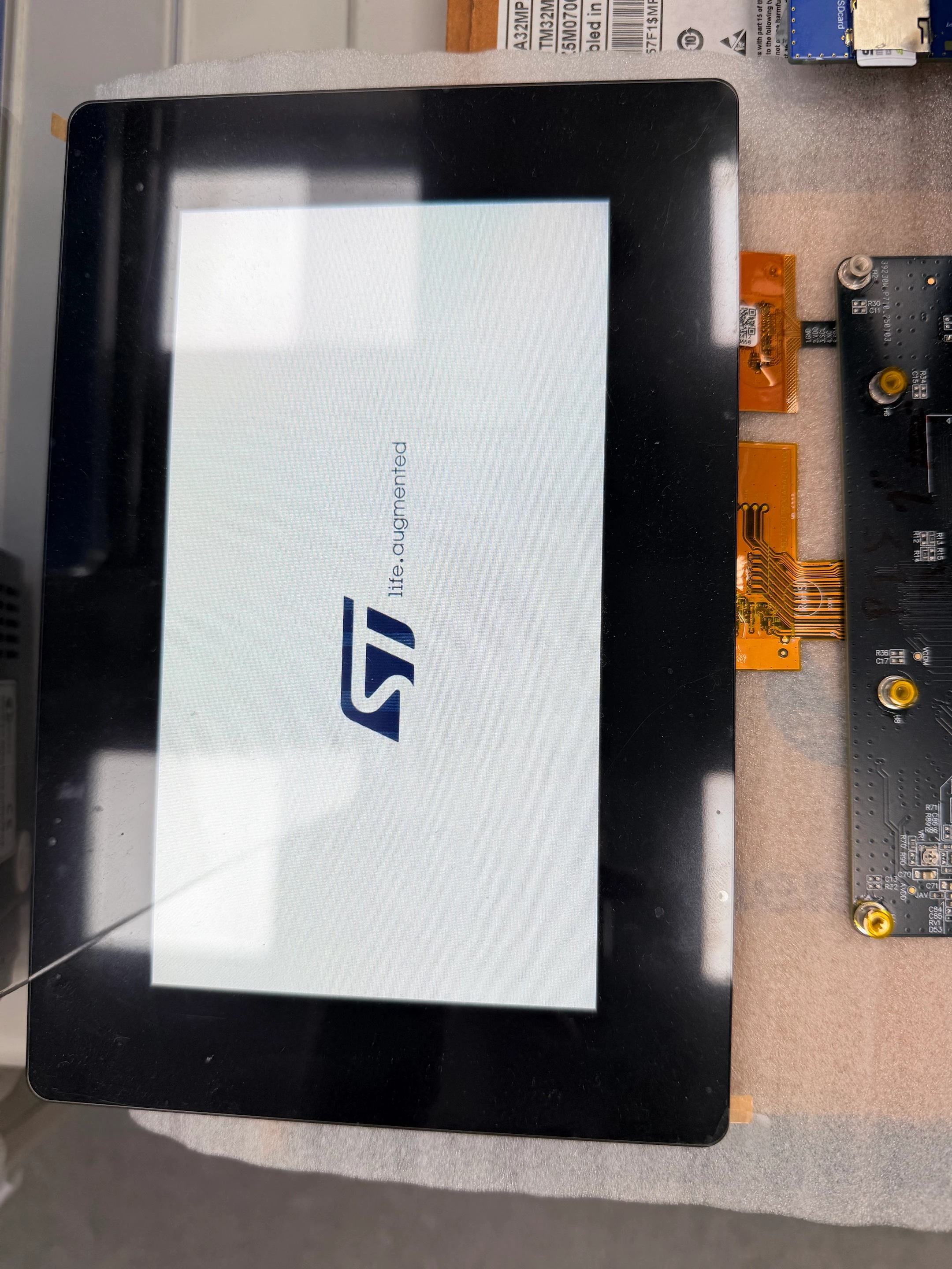

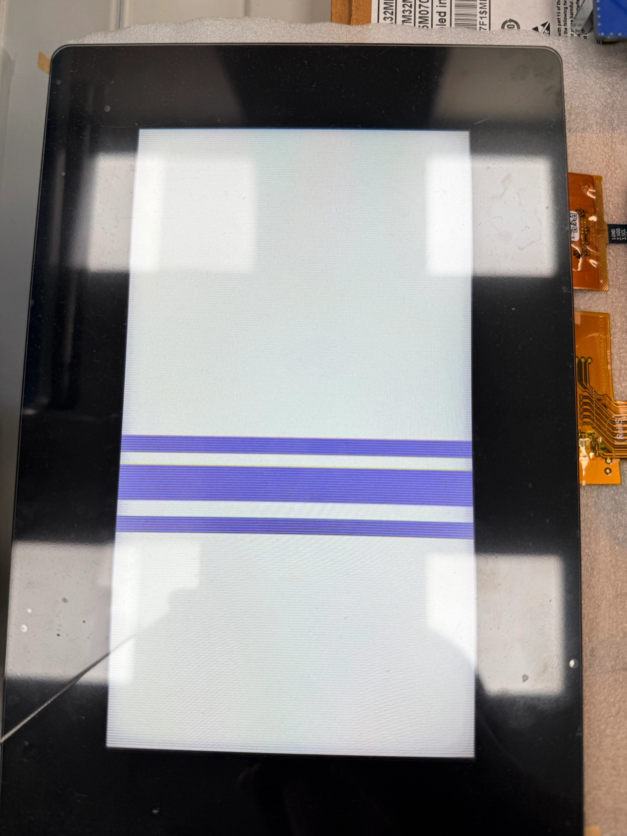

I confuse that if u-boot pixel clock is fixed? I found some message in stm32_ltdc.c driver, it notes "TODO Below parameters are hard-coded for the moment..."
Now, I set abnormal panel-timing can work on u-boot, but it cannot work on kernel. I attached the panel pictures.
In u-boot:
In kernel:

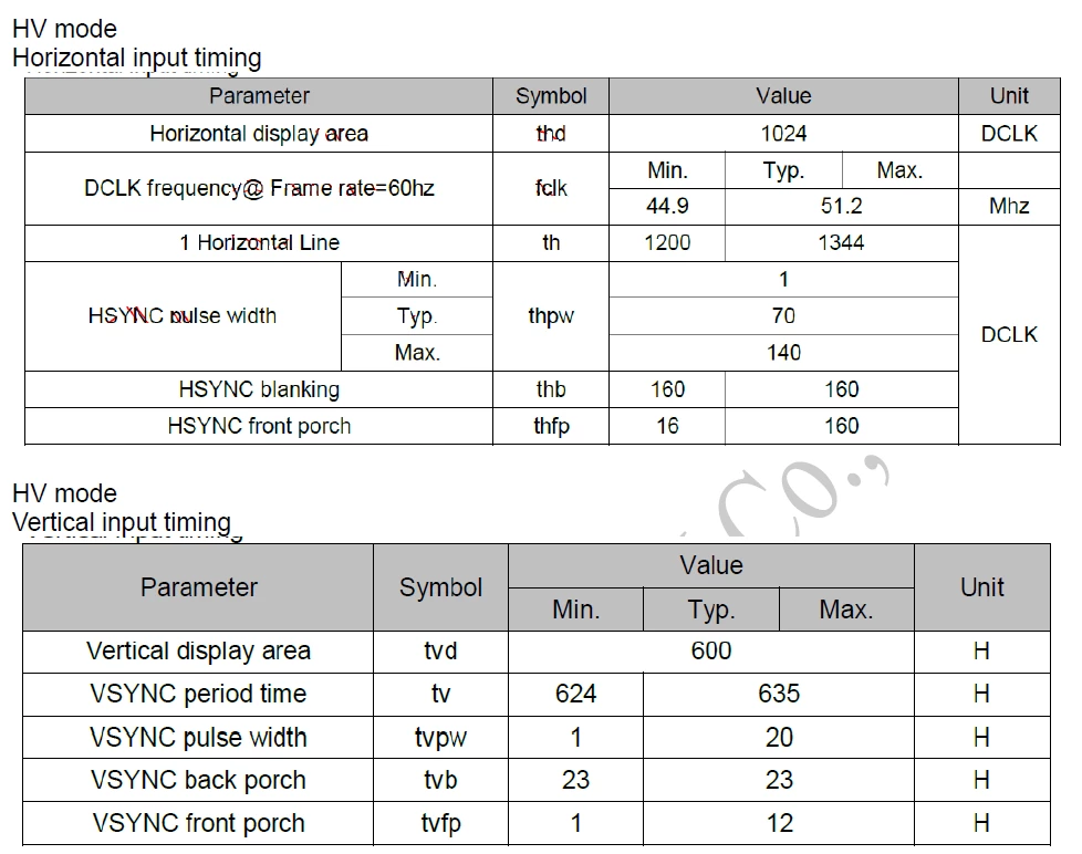

Tim_hoAuthor
September 9, 2025
Yes, I have the panel spec as below.
My previous question is the pixel clock is fixed in u-boot? I found some message in stm32_ltdc.c driver, it notes "TODO Below parameters are hard-coded for the moment..."
Do you know why this comment is there? Is it means that I need to set fixed parameters?
Besides, could I use the panel-simple.c driver in kernel to drive my panel? Or I need to write my panel driver?
I found the panel is used "stm32_ltdc.c" driver in u-boot to drive the panel and it would according to "stm32mp257f-ev1.dts" device tree to configure our panel. So, I don't need to write my panel driver in u-boot?
I tried to use the same panel timing in kernel and u-boot stages, but it seems that the timing cannot effect in kernel device tree.
