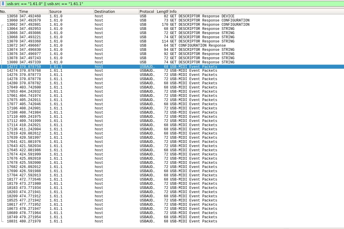

Erwan SZYMANSKI
Apr 6, 2022 2:23 PM UTC
Hello @KChar.1​ ,
Well I think I have something very close to your setup right now. Find below my Wireshark packet when we can identify USB packet when I plug to the USB-midi gadget, and then the MIDI packets that pass through when I want to play my midi piano file.
0693W00000Lx6zqQAB.pngOn board side, I plugged an HDMI monitor, quite standard, to make some HDMI activity. Should it be enough to replicate ? Do you need to have some screen activity to make it crash ?
