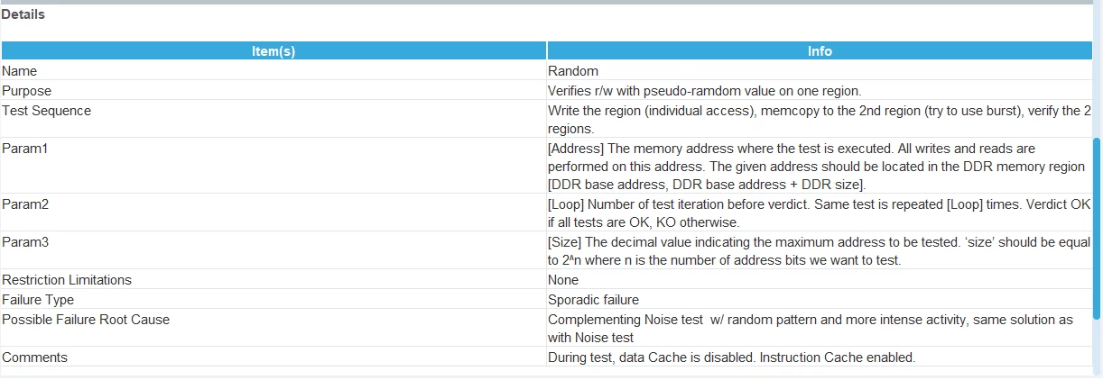

I am yet to find out where the tests are defined, I am new to this. so I am not sure about the random test parameters used.
I beleive the tests are defined in the SPL image of the SD card?

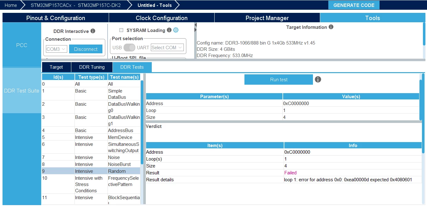

Let me explain what I am doing and I will share a screen shot of the error, it will then give you an idea.
I am using STM32MP157-DK2 board and the SD card which came with it.
I set the boot pins so that it boots from SD card. (boot0=1, boot2=1)
I created a project on STM32CubeMX 6.0.1 for the above board and I Initialize all peripherals with their default Mode
I carried out the test from Tools>DDR TestSuite.
I am able to connect to the board by selecting connect from DDR interactive section. (it is using the SPL from the SD card)
I am able to run all test except test number 9, (Intensive Random)
Please see the attached screen shot
hopefully you have all information you needed,

I found more information about the test no 9, see attched schreenshot0693W000004GunbQAC.png
Olivier GALLIEN
Sep 25, 2020 2:29 PM UTC
Hi @BalaGajenthan​
Could you please try to change parameter size to 8 and tell us result please ?
Is failure random or systematic ?
Thx
Olivier

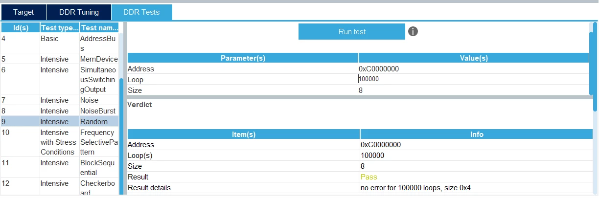

BalaGajenthan
Sep 25, 2020 2:56 PM UTC
Hi @Community member​
Thanks for the reply.
with size 8, The test always passes,
with regards to the version number, you are right I am running CubeMX 5.6.1. some how I got this wrong.
