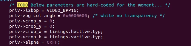

Change the background color of uboot logo, it cannot be changed
  • December 15, 2020
  • 1997 views
The drivers/video/stm32 stm32_ltdc.c in this file.The background color is black, and the modification is as follows:
0693W000006Fk2RQAS.pngIt's still white

KnarfB
December 15, 2020
The first byte is alpha value/opacity. What happens if you say 0xFF0000FF. Blue?

December 17, 2020
0xFF0000FF cannot set the background to blue. Change the bg_col_argb, the background color will not be changed
